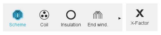

A scrolling selection bar helps to choose the section in which one can define the winding settings.
Here are the sections available to design the winding step by step:
  • “Scheme” to build the winding architecture.
  • “Coil” to set how the coil is defined and to see how the pole is wound.
  • “Insulation” to define all the winding insulations.
  • “End winding” to define the dimensions of the end-windings.
  • “X-Factor” to adjust phase resistance and end-winding inductance.
Figure 1. Sections to design the field winding step by step
