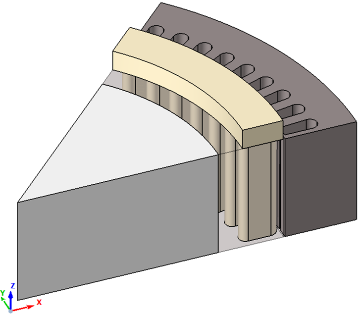

Induction Machine - Magnetic AC 3D solution (New)
The studied device, represented in the figure, is a 4 pair poles induction motor, 3-phases star connected, characterized by:
  • rated – load power, Pn = 3 kW
  • rated source voltage, Un= 400 V (line to line value)
  • rated source frequency, fn = 50 Hz
Description in progress
