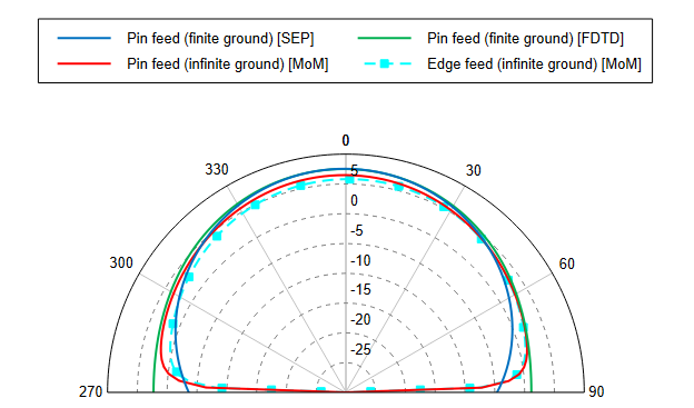

Compare the gain (in dB) of the requested far field patterns on a polar
plot.
Figure 1. A polar plot of the requested E plane radiation
pattern for the microstrip patch models in POSTFEKO.
Note: Observe the impact of the different feeding mechanisms on the radiation
pattern.
The best design for manufacturability (DFM) is the model using the
finite ground. The finite ground version requires more time to solve compared to
the infinite plane version.
