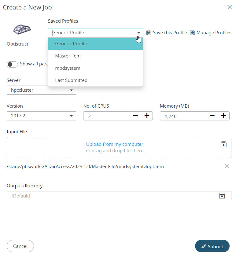

Click
below the Saved
Profiles to view the list of saved Profiles.
Figure 3. Generic Profile
Note: By default, only Generic Profile and Last Submitted profile will be listed if there are no saved profiles.The list of profiles is displayed.Figure 4. Saved Profiles List

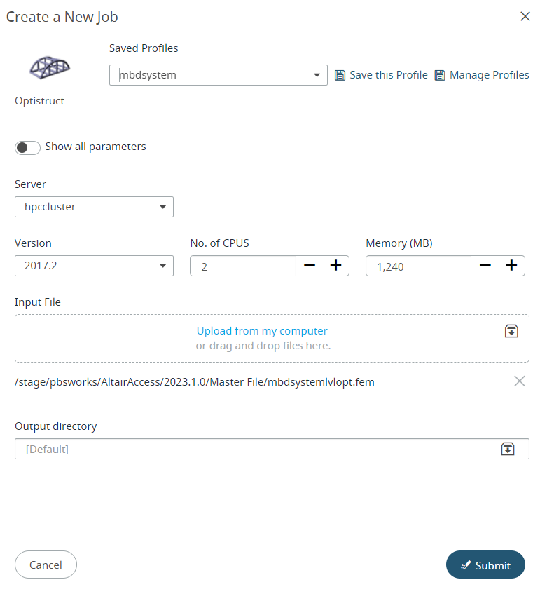

Select the Profile from the drop-down list.
The selected profile job submission form with the pre-populated parameter is displayed.
Figure 5. Saved Profile Job Submission Form
Note: Click Manage Profiles to set the profile as a default profile, rename, or delete a saved profile. - Edit the required solver parameters.

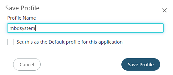

Click Save this Profile.
Tip: Solver parameters that are left blank when creating a profile can later be populated when submitting a job by displaying the job submission form.The Save Profile dialog box is displayed.
Figure 6. Update Saved Profile
Note: When you are saving the profile if the solver parameters are left blank in Job Submission form, then the Saved Profile name is suffixed with GUI while displaying the Profile name in the context menu. - Select the Set this as the Default profile for this application check-box to set this profile as a default profile.
Click Save.
Note: Enter a profile name if you want to save it as a different profile.
