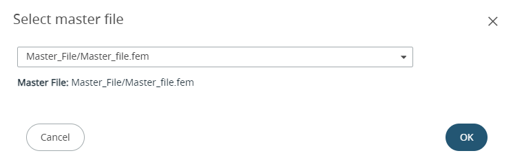

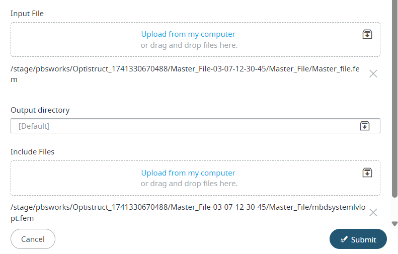

                Select an input file.
                If a Master File is selected as an input file, then the include files will be listed by default.
Access Web now provides an option to upload a zip file containing the master file and the include files.
Note: You can upload Master File zip while uploading an input file by selecting Upload from my Computer or when you drag and drop an input zip file from your local system.If a zip file containing the master file and include file is uploaded as an input file, then -
                Enter the Output Directory.
                By default, the output directory is created in the same location where the input files are located.Tip: Click Save this Profile to create a customized profile with the pre-populated parameters.
                Click Submit.
