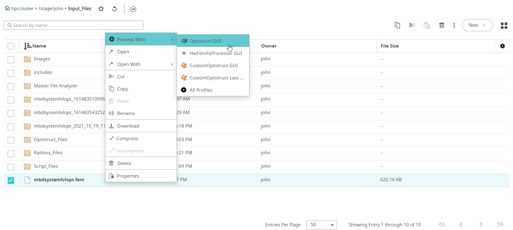

                        navigation path. - Right-click the job input file.
                From the context menu, select Process With.
                Solvers or profiles suffixed with "GUI" indicate that additional information is required to submit the job. In this case, a Job Submission Form is displayed so that the information can be supplied.Tip: Select All Profiles to set a default solver or profile for the input file type (based on the file extension) or to force the solver's job submission form to be displayed so that it can be customized.A list of solvers and profiles specific to the file type of the job input file are displayed.

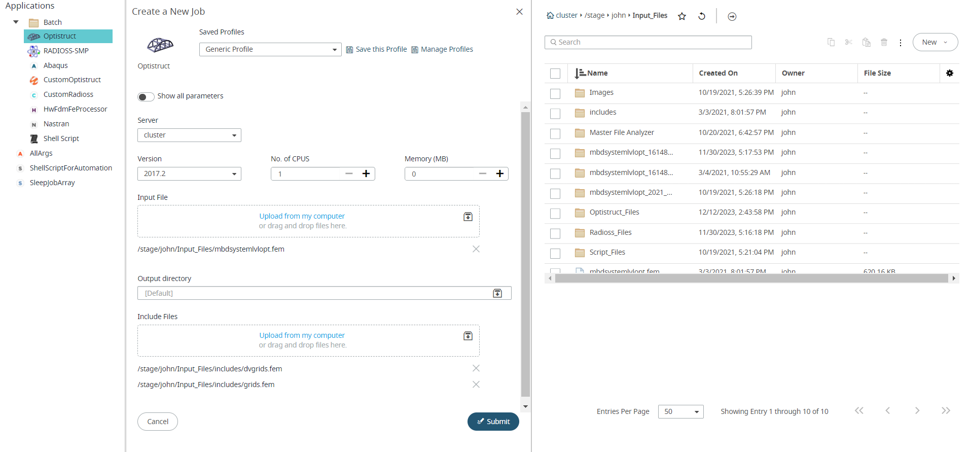

 - Select a solver or job profile.
                If additional information is necessary to submit the job, then a job submission form is displayed. Otherwise, the job is instantly submitted.A job submission form is displayed based on the selected solver or profile containing the required application arguments for the application. Values for these arguments must be entered for the job to be successfully submitted. Each application will have its own unique arguments.
Figure 2. Job Submission Form
                Fill in the required application arguments.
                Tip: Click Save this Profile to create a customized profile with the pre-populated arguments.
                Click Submit Job.
                The job is submitted and a notification is displayed providing the status of the job.Tip: Click on the Job ID link provided in the notification to view the job status.
