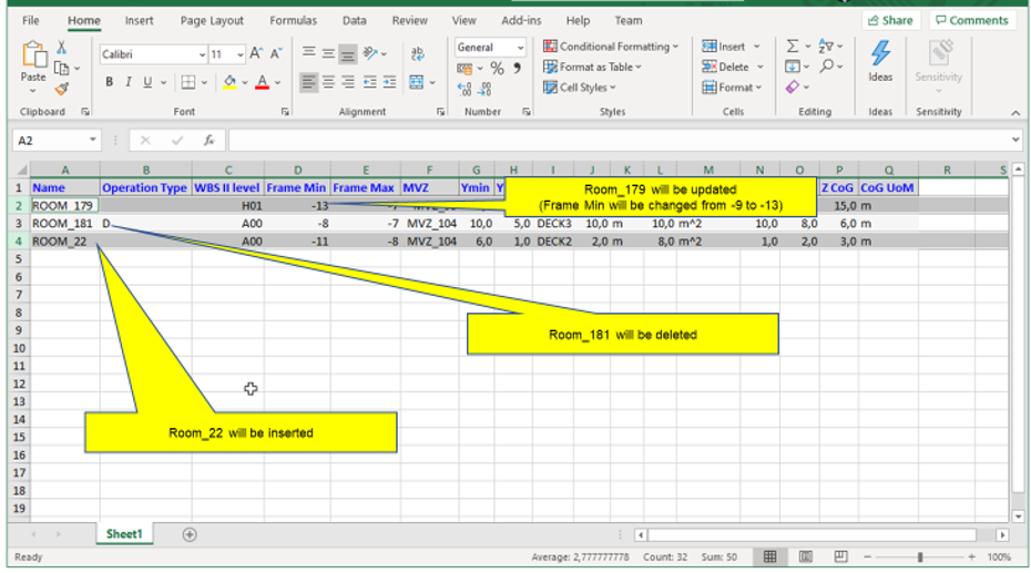

The Upload procedure will parse the upload file row by row and it will perform a specific action on data present in the row as follows:
  • “Room Name” column contains the key value for a Room.
  • “Operation Type” column value will be used to execute Room delete operation.
  • Insert a new Room in case data in the row specify a Room that is not already present in the system.
  • Update an existing Room using data in the row.

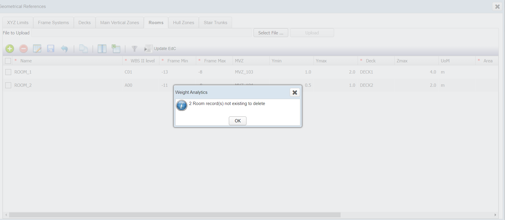

    • Delete an existing Room if the “Operation Type” column value is “D”. If the Room name specify a not existing Room, then a Message Pop up will appear after the Upload procedure execution. (see below).

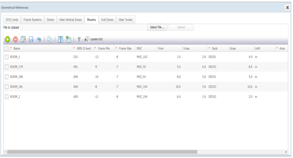

Room Data before the upload:
Example of Upload file:
