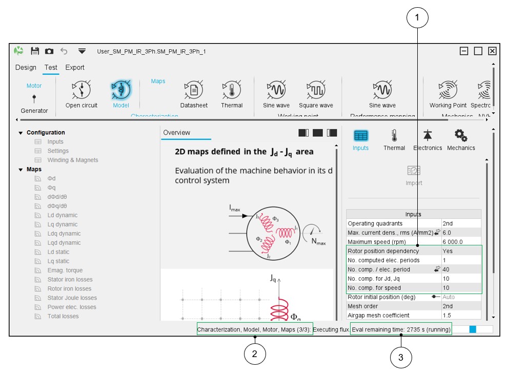

This information is displayed in the status bar, along with the progress information about the significant intermediate steps of the current test. You can see an illustration below.
Table 1. Motor Factory – Test area – Time estimation bar - Example
1 Parameters impacting on the complexity of the test.
2 Information about the progress.
3 Estimated remaining time.
