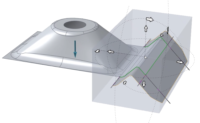

  8. The rectangular box shows the size of the extended part.
    • You can adjust the size and orientation of the box by using the graphical manipulator on the box face.
  9. Adjust the extension surface:
    Note: In the modeling window, the extended surface intersection with the box is indicated by a green line. A discontinuity in the green line indicates the surface has not been extended sufficiently and should be fixed.
