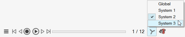

Animation Toolbar
Use the animation toolbar to play, record, and configure the animation.
Figure 2. Animation Toolbar

Tip: If a model has multiple systems, you can choose among a model's systems using the System button in the Animation toolbar.
