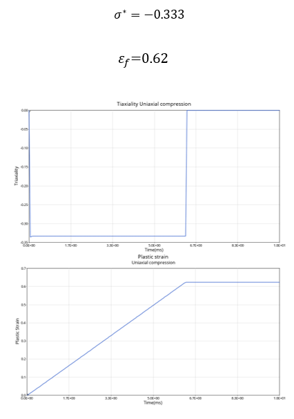

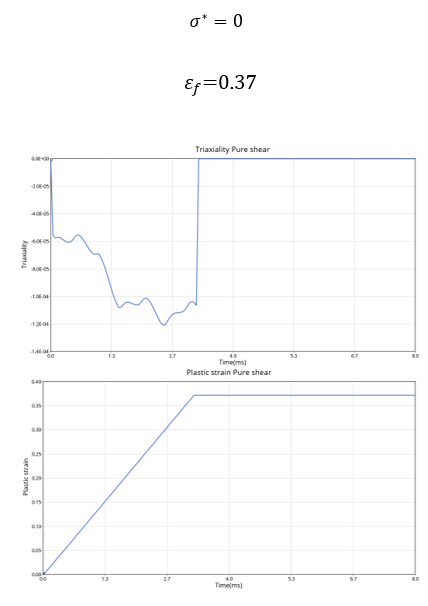

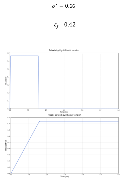

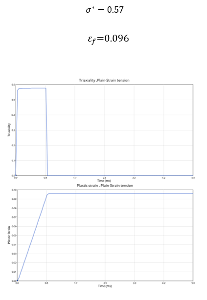

Square Coupon with SHELL Elements
- /PROP/TYPE1 (SHELL), QEPH shell formulation Ishell=24, 5 integration points over the thickness.
For each loading, the triaxiality and plastic strain curves are represented at failure.
| Pure Tensile | Pure Shear | Pure Compression | Plain Strain Tension | Biaxial Tension |
- Pure tensile
- Pure shear
- Pure compression
- Plain strain tension
- Biaxial tension
