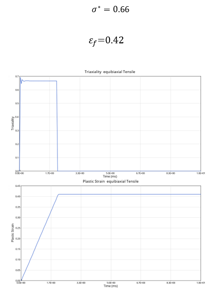

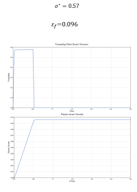

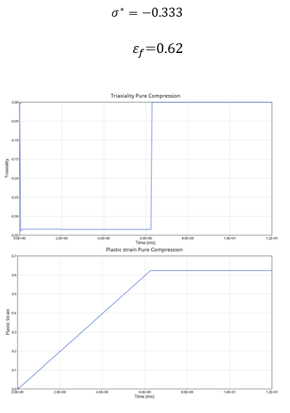

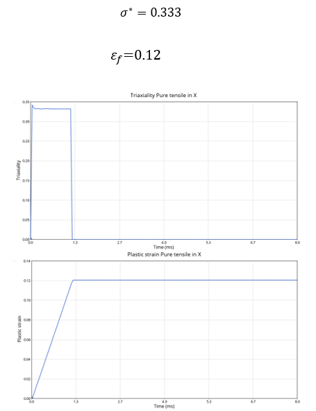

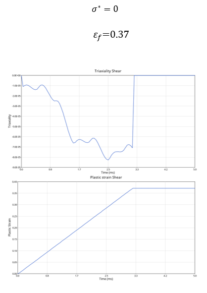

For each loading, the triaxiality and plastic strain curves are represented at failure.
| Pure Tensile | Pure Shear | Pure Compression | Plain Strain Tension | Biaxial Tension |
As expected, the elements failed once they reached the plastic strain, then the
stress decrease:
- Pure tensile
- Pure shear
- Pure compression
- Plain strain tension
- Biaxial tension
