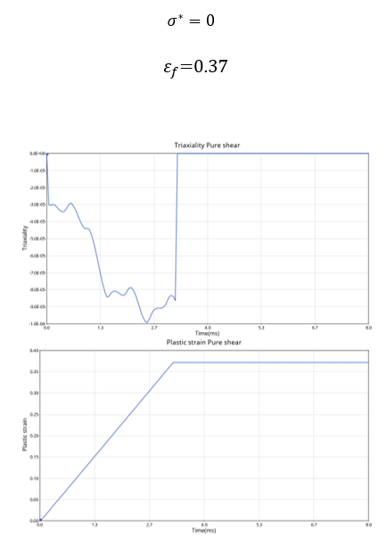

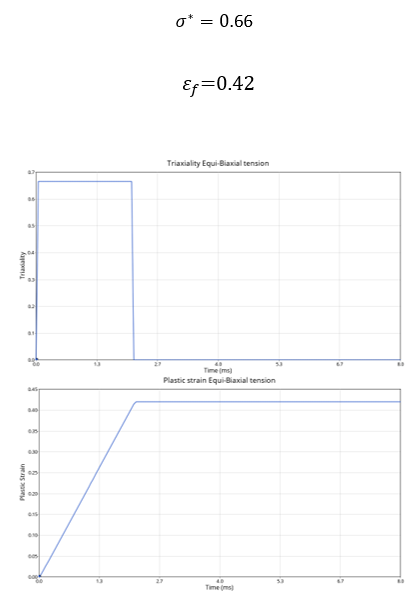

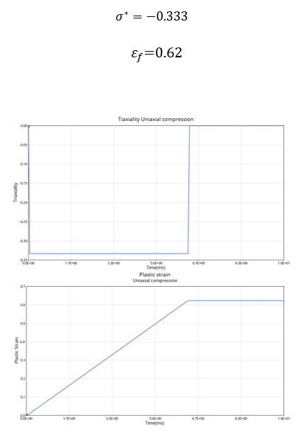

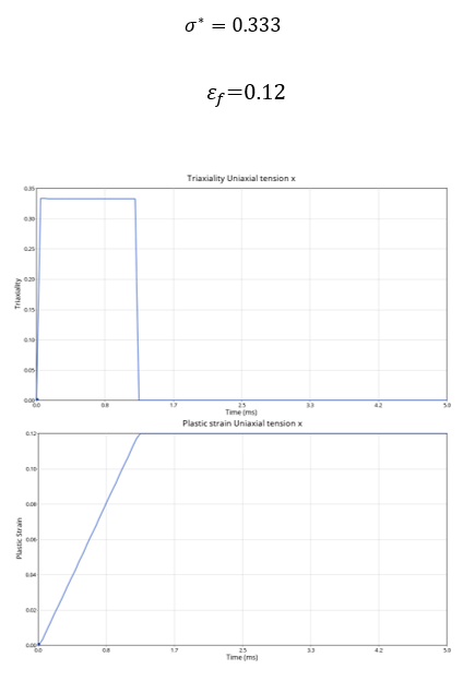

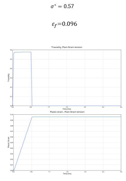

Square Coupon with SH3N Elements
- /PROP/TYPE1 (SHELL), QEPH shell formulation Ish3n=0, 5 integration points over the thickness.
For each loading, the triaxiality and plastic strain curves are represented at failure.
| Pure Tensile | Pure Shear | Pure Compression | Plain Strain Tension | Biaxial Tension |
- Pure tensile
- Pure shear
- Pure compression
- Plain strain tension
- Biaxial tension

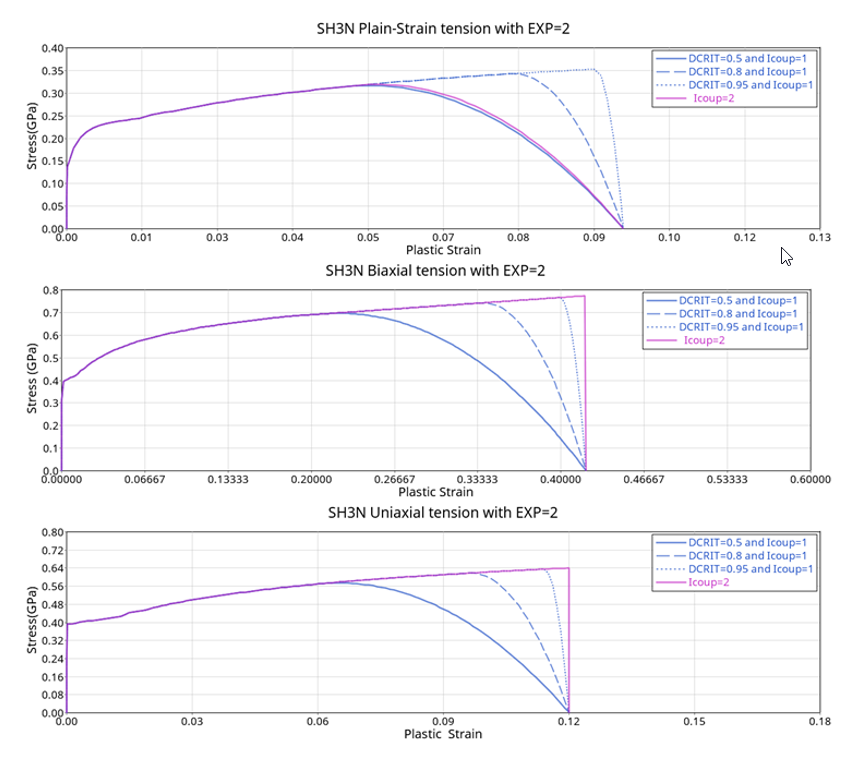

Effect of /FAIL/BIQUAD parameters on damage
- ICOUP=1 with
S-Flag=2
- DCRIT=0.5
- DCRIT=0.8
- DCRIT=0.95
- ICOUP=2 with
S-Flag=3
Figure 1. Effect of DCRIT parameter on stress softening triggering
With ICOUP=1, the critical damage parameter DCRIT is tested with different values. The more the value of DCRIT is increased, the later the softening is applied on the stress. The exponent parameter EXP is used to control the shape of the stress softening, so that it is nonlinear when EXP is different from 1.
With ICOUP=2, the instability curve represents the criterion that must be reached to trigger stress softening, implying the beginning of the strain localization and then necking, especially observed at high stress triaxiality.
