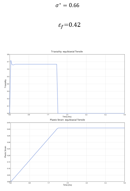

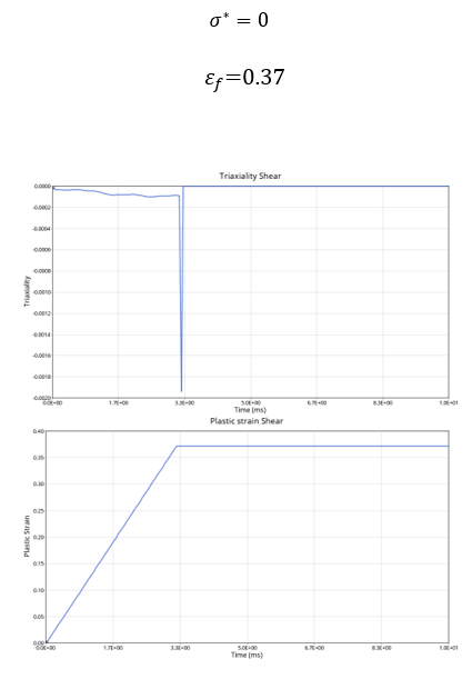

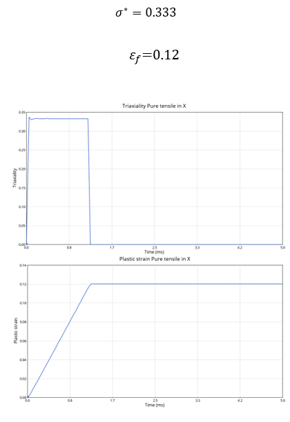

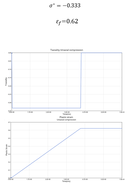

For each loading, the triaxiality and plastic strain curves are represented at failure.
| Pure Tensile | Pure Shear | Pure Compression | Plain Strain Tension | Biaxial Tension |
As expected, the elements failed once they reached the plastic strain, then the
stress decrease:
- Pure tensile
- Pure shear
- Pure compression
- Plain strain tension
- Biaxial tension

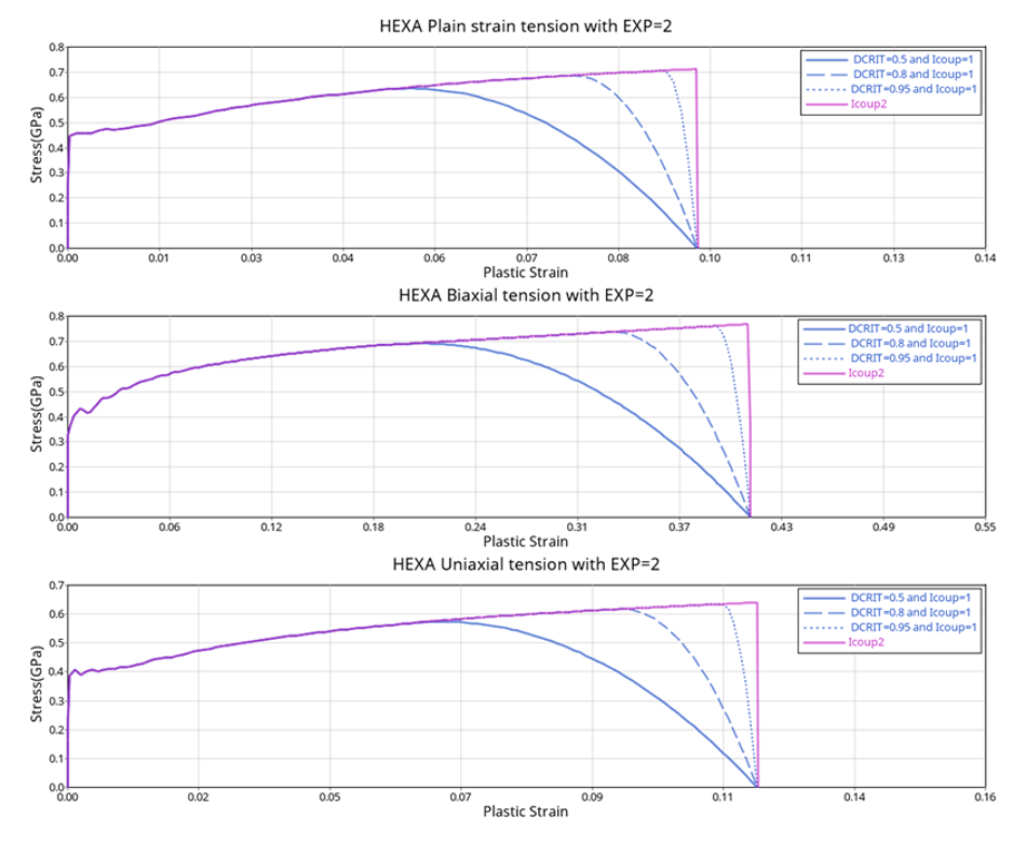

Effect of /FAIL/BIQUAD parameters on damage
The following parameters are tested:
- ICOUP=1 with
S-Flag=2
- DCRIT=0.5
- DCRIT=0.8
- DCRIT=0.95
- ICOUP=2 with
S-Flag=3
Figure 1. Effect of DCRIT parameter on stress softening triggering
With ICOUP=1, the critical damage parameter DCRIT is tested with different values. The more the value of DCRIT is increased, the later the softening is applied on the stress. The exponent parameter EXP is used to control the shape of the stress softening so that it is nonlinear when EXP is different from 1.
With ICOUP=2, no influence on softening can be observed when using thickshell elements.
