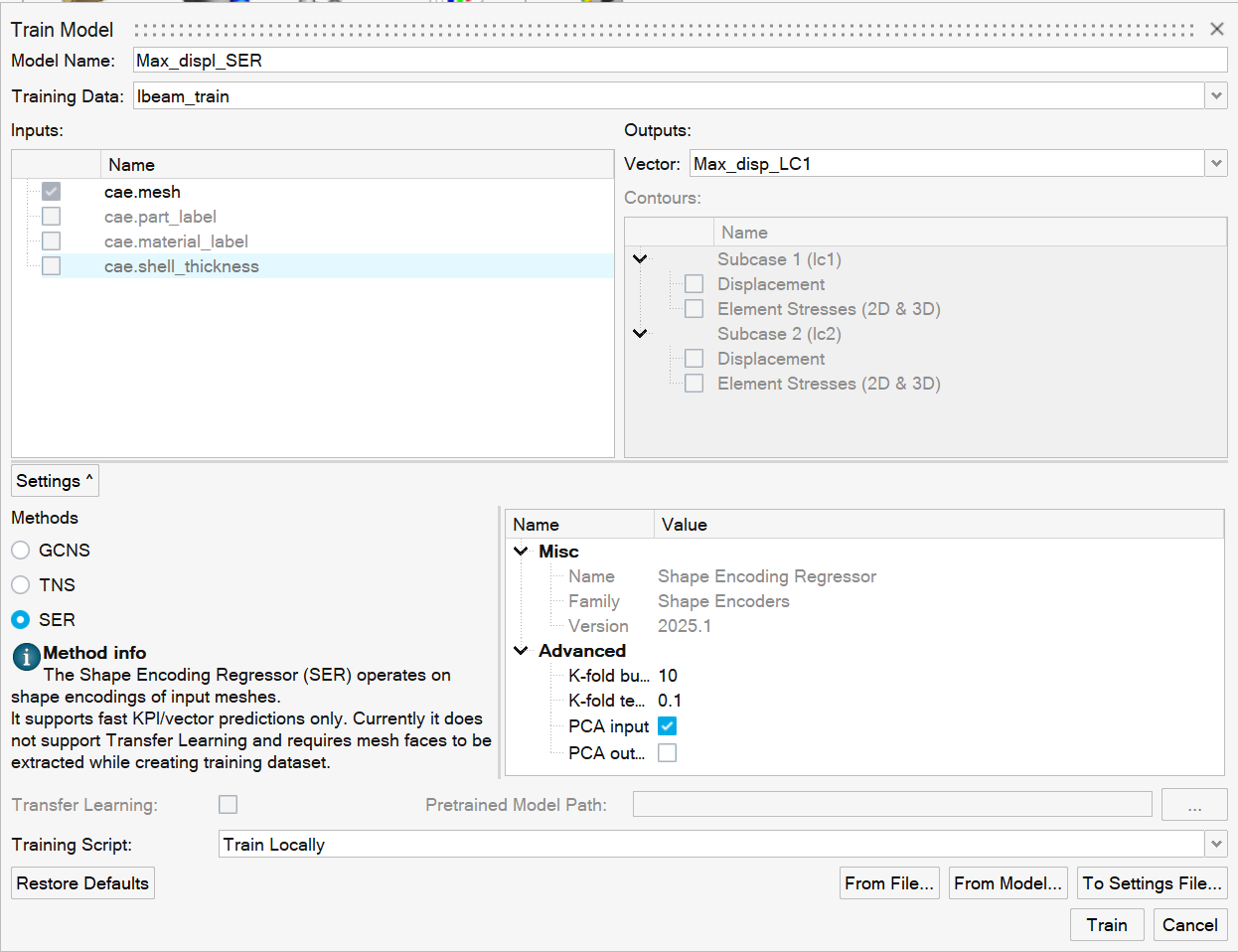

- New Architecture: Shape Encoding Regressor
 - The Shape Encoding Regressor (SER) architecture uses the shape encodings
                            of the training samples to fit multiple regressions. The predictions are
                            restricted to scalar KPIs and vector curves (no contour results).

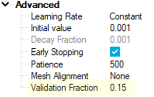

 - User Input Validation Fraction
 - Validation datasets are useful in preventing overfitting on large datasets. However, on small datasets it can lead to the selection of a suboptimal epoch as the best model configuration.

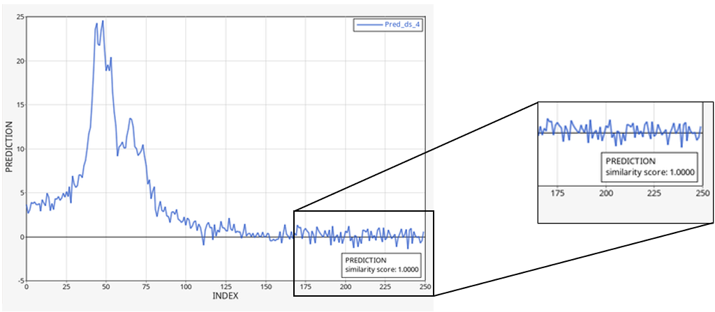

 - Similarity Score for Curve Prediction
 - Similarity score is now available for curve predictions.

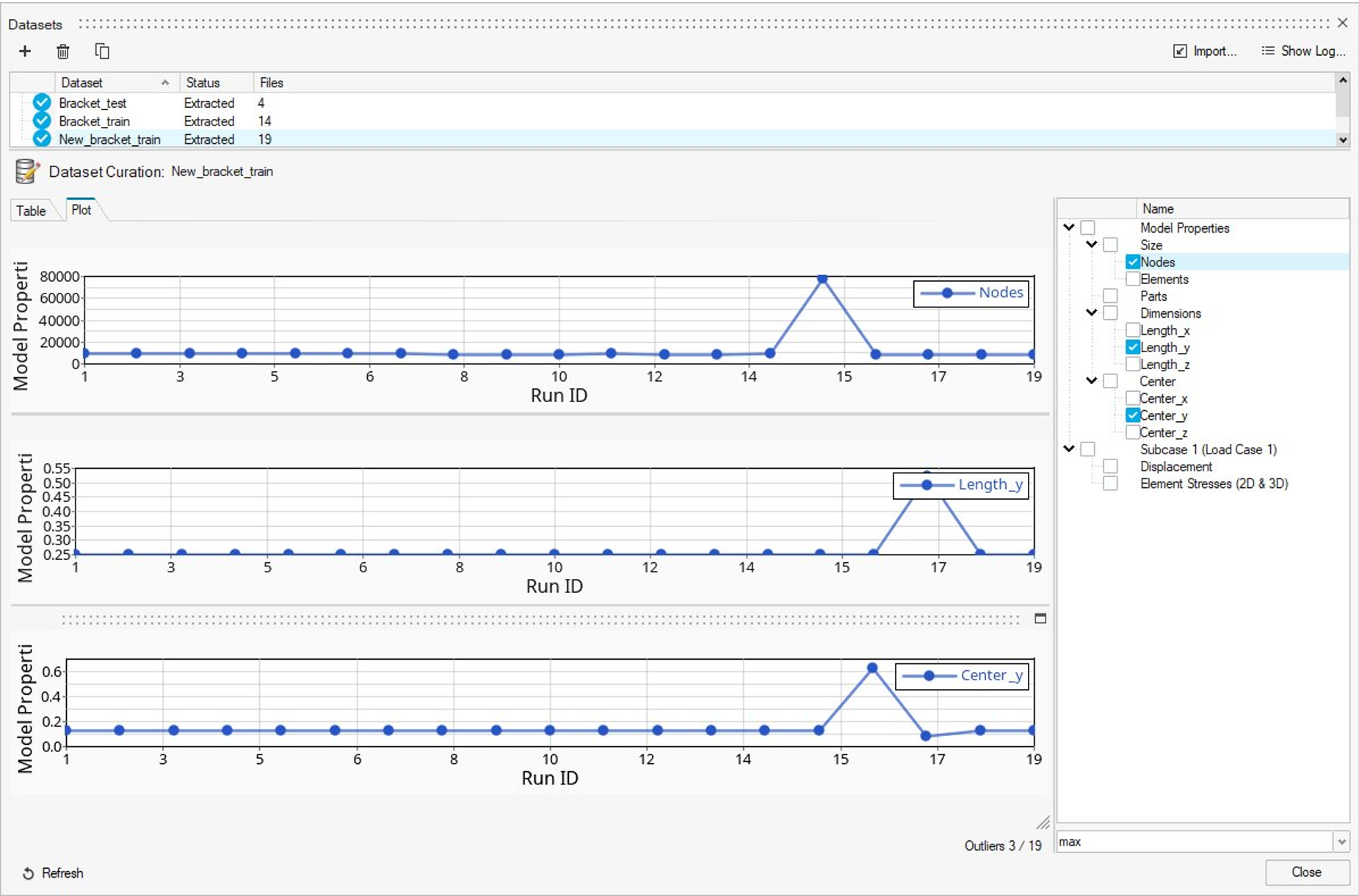

 - Enhanced Data Curation Capabilities
 - The data curation features (part of dataset creation) have been
                            significantly enhanced. The updates can be divided into two categories:
                            data inspection and data management.

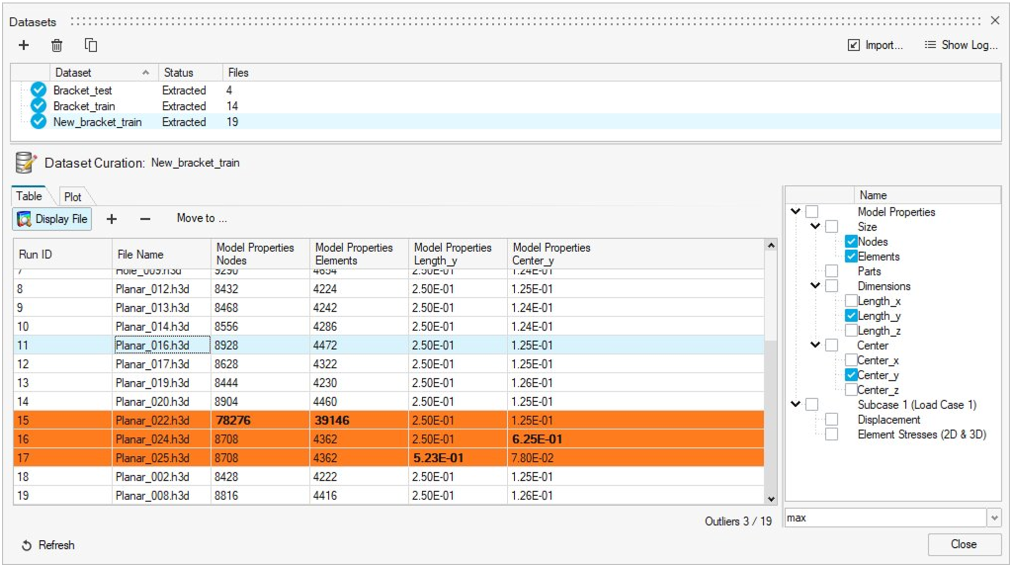

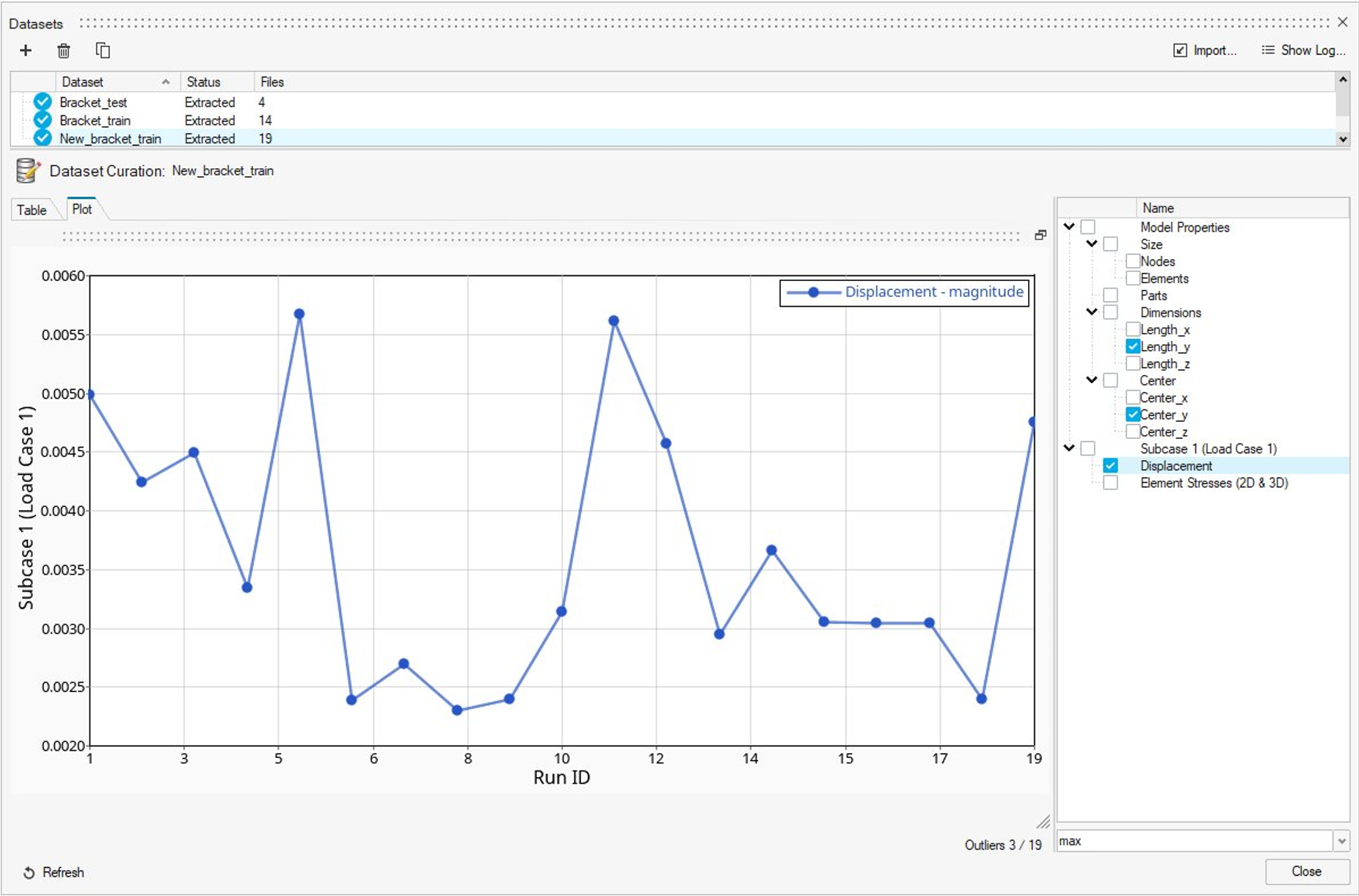

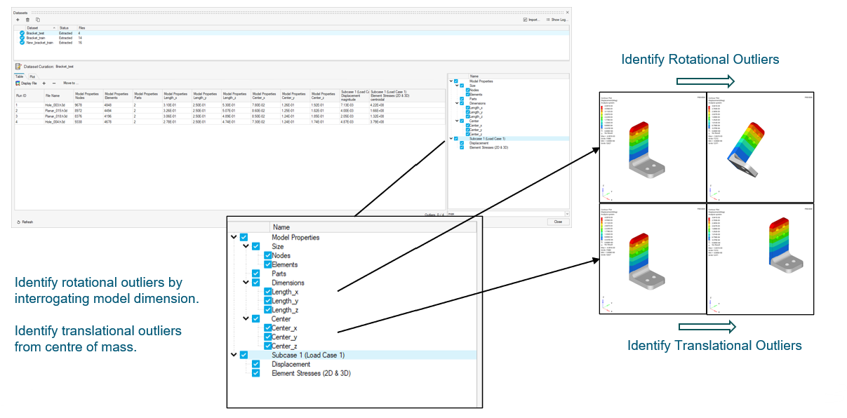

- Data Inspection
 - Updates to the model summary and results metrics table:
                                        outliers are now automatically identified and highlighted in
                                        orange. The outlying columns are also displayed. The
                                        outlying KPI value is highlighted in bold font. You can
                                        select or remove additional responses by interacting with
                                        the tree shown on the right side of Figure 4.
Figure 4.

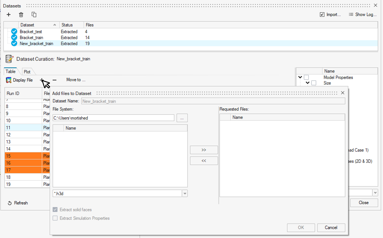

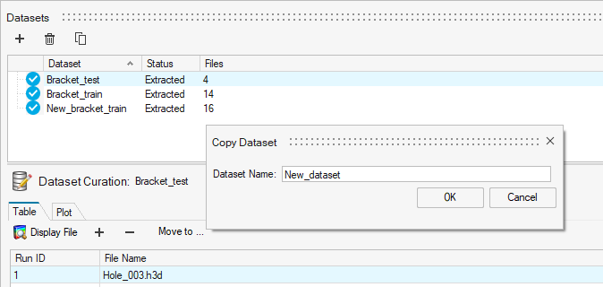

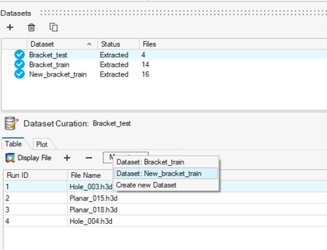

 - Data Management
 - Datasets can now be edited to add more samples or remove
                                            outliers.
Figure 8.
Figure 9.

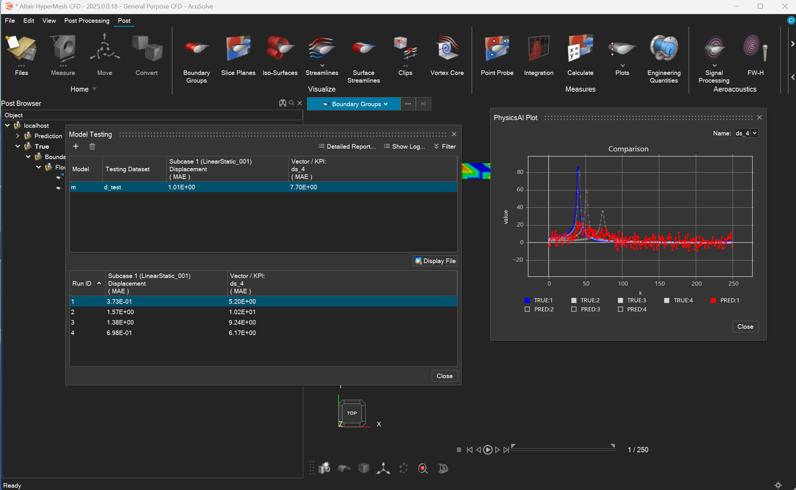

 - KPI and Curve Prediction Visualization in HyperMesh CFD
 - The PhysicsAI ribbon inside HyperMesh CFD can now display
                                        the predicted curves and KPI.
Figure 12.

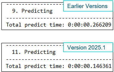

 - Faster Predictions
 - Prediction time on new designs now takes 50% less time
                                        compared to earlier versions.
Figure 13.
