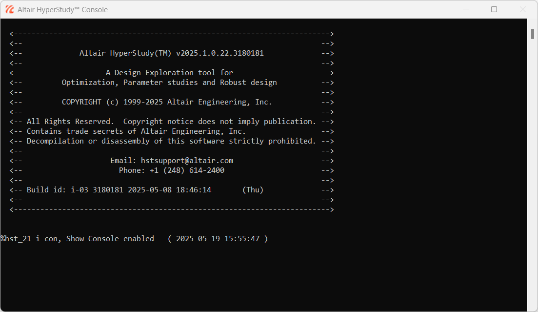

- Show Console
- Displays the HyperStudy console.
