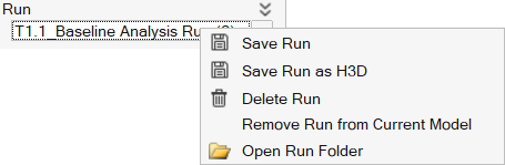

    Tip: Right-click the run name for additional options:
    • Select Save Run to save the current run as an .iform file.
    • Select Save Run as H3D to save the model and result data for all load cases to an .h3d file.
    • Select Delete Run to remove the current run from the Analysis Explorer, the model, and the run folder.
    • Select Remove Run from Current Model to remove the current run without removing it from the run folder.
    • Select Open Run Folder to open the run folder in the system file browser.

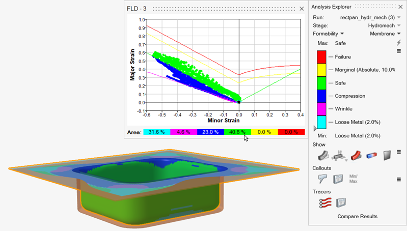

    Formability
    Formability describes the principal strains on the surface of the sheet metal, also known as Major and Minor strains, which are plotted against a Forming Limit Curve to identify the different deformation zones that occur during the stamping process. Each color indicates a unique deformation zone during stamping.
    • Red: High potential for failure from splitting due to excessive deformation.
    • Yellow: Marginal potential for failure.
    • Green: Safe with no potential for failure.
    • Blue: Material is compressed.
    • Violet: Wrinkling zone with potential for failure.
    • Cyan: Loose metal zone indicates that material is not sufficiently deformed.
      Note: When viewing Formability results in the Analysis Explorer, the Area display shows the percentage of the model's surface area that is represented by each status.

    Figure 1. Example Feasibility Results Showing Deformation Zones
