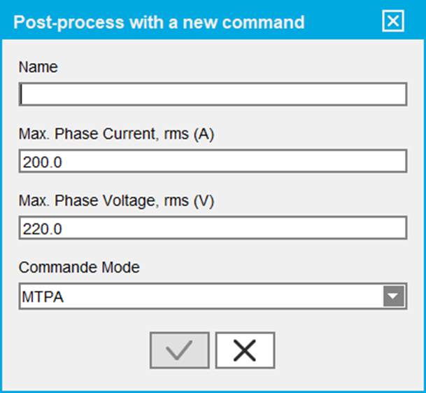

Post-process with new command
In previous releases, if a user wanted to compute a new test with the same inputs from than a previously solved test except for “Command” inputs (“Max. Phase Current, rms (A)”, “Max. Phase Voltage, rms (V)”, or “Command Mode”), he had to run a new test which can be very long.
In release 2022, it is possible to post-process a new test from a previously solved one, modifying only the “Command” inputs, in only few seconds.
In the TESTS table, a new button has been added in the table header. It is enabled when a valid test is selected and it allows to post-process the selected test with new command inputs.
A new popup menu has also been added on valid tests.
Both the button in the header and the popup menu open a “Post-process with a new command“ dialog filled with the selected test values.
Filling the fields with the new customs values and validate the dialog will automatically create a new test in the TESTS table and generate the maps in few seconds.
Restriction : Because of the extrapolation process used to compute the post-processed test with new command, the new value for “Max. Phase Current, rms (A)” should follow the constraints bellow:
  • Imax is the initial value of the “Max. Phase Current, rms (A)”. It will always be the value of the original fully computed test, even if the test is post-processed from another post-processed test.
  • Then ImaxNew should be 0.5*Imax ≤ IMaxNew ≤ Imax otherwise extrapolation may cause accuracy loss. A warning message is displayed in that case.
  • ImaxNew < √2*Imax otherwise an error message will be displayed
