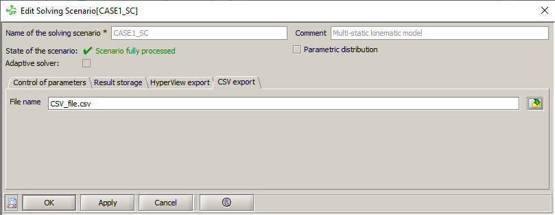

Export of the CSV file, in Flux
The export is accessible via the dialog box of the Solving scenario, in the tab CSV Export:
The steps to export the CSV file are detailed below:
  1. Open / Create a solving scenario
  2. Define the parameters to be changed in the resolution (if not yet defined)
  3. Choose a name of the CSV file which should contain data
  4. Validate the solving scenario
  5. Launch the solving process
    → The CSV file is created and filled as the steps are solved
    → The CSV file can be consulted during resolution simply by opening it
