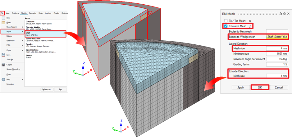

Geometry import and meshing
After importing the provided motor 3D CAD file (*.xmt_txt format), SimLab's EM Mesh tool can easily generate an extrusive mesh suitable for the 3D motor analysis.

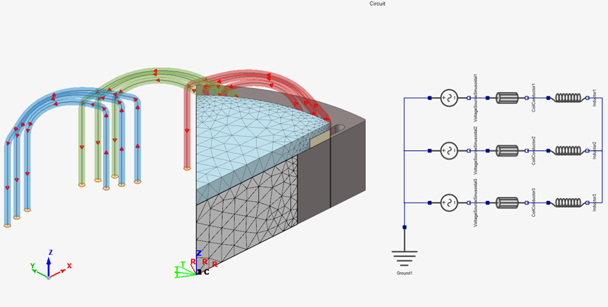

As shown in the figure below, after setting up all the required LBCs, non-meshed coils and the coupling circuit, the configuration of basic steady-state solution is completed.

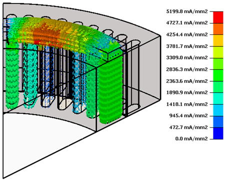

Post-processing: current vector visualization in the squirrel cage.

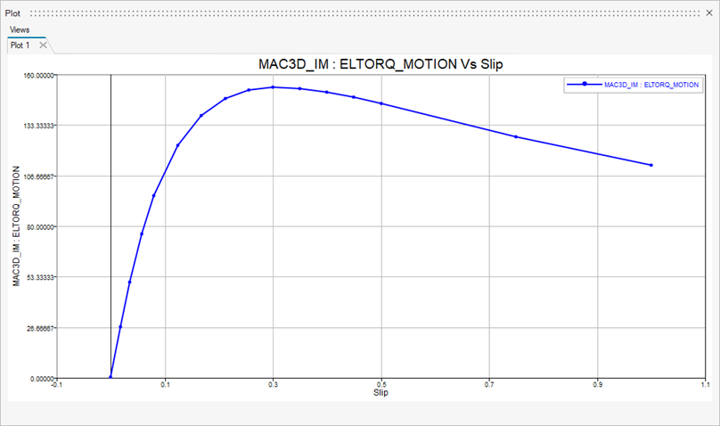

Study 2: Torque-speed characteristic

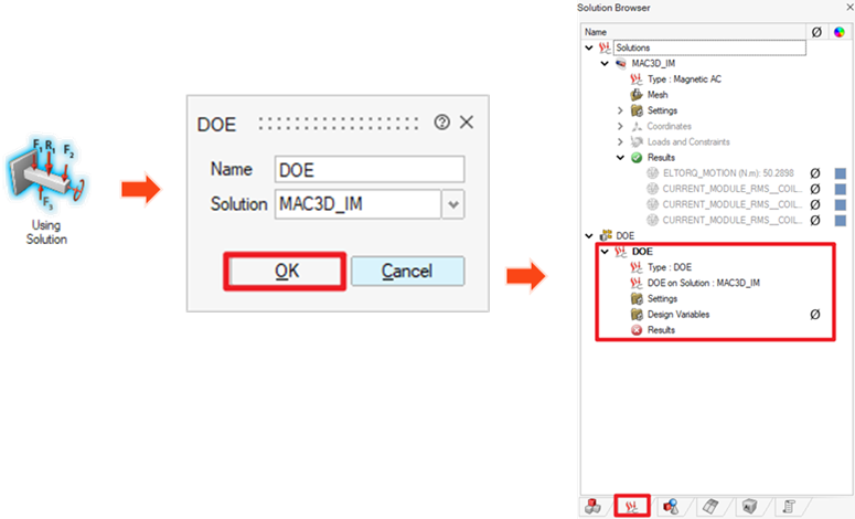

The previous basic steady-state solution can be further connected with a DoE solution in SimLab to run parameter sweeps.
The Torque v.s. SLIP curve can be obtained after setting the scanning parameter to SLIP
