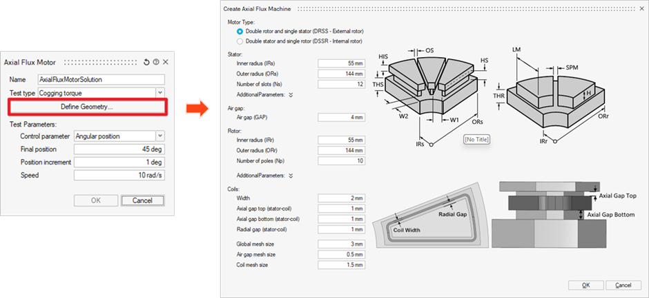

Motor geometry creation: AFM template
The AFM solution has a built-in AFM modeling tool that can help users quickly implement 3D parametric modeling.
Study 1: Cogging torque analysis
After the user defines the geometry of the motor, the AFM solution can automatically generate all the LBCs required for cogging torque analysis.

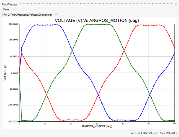

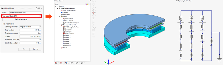

Study 2: Back-EMF analysis
Same as the cogging torque analysis, the AFM solution can automatically generate all the LBCs (including the coupling circuit) required for the back-EMF analysis.
Back-EMF results:

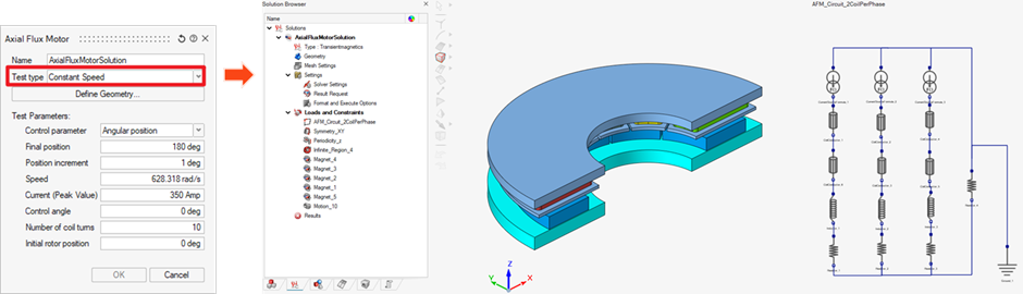

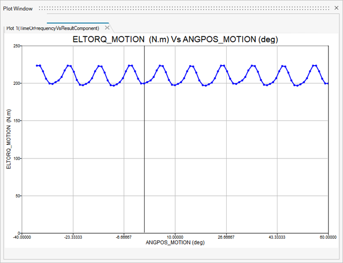

Study 3: Working point analysis
Same as the two previous analyses, the AFM solution can automatically generate all the LBCs (including the coupling circuit and the current expressions) required for the working point analysis.
