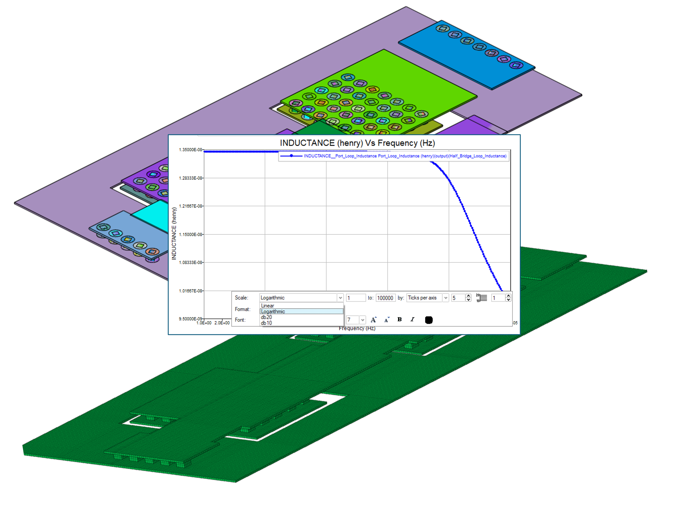

| Parasitics Extraction | PE - Loop Inductance Half Bridge | This study case computes loop inductance for dual-side ground-return routing using Impedance computation from 1 Hz to 100 kHz. | ![]() |
