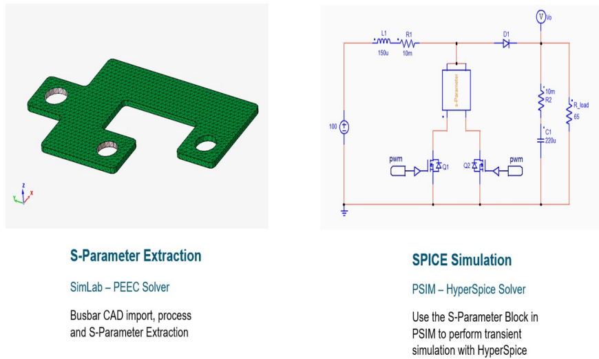

This study deals with a busbar modeling to simulate MOSFET Current Sharing using SimLab to extract S-Parameters, and then use S-Parameter block in PSIM to compute the currents.
