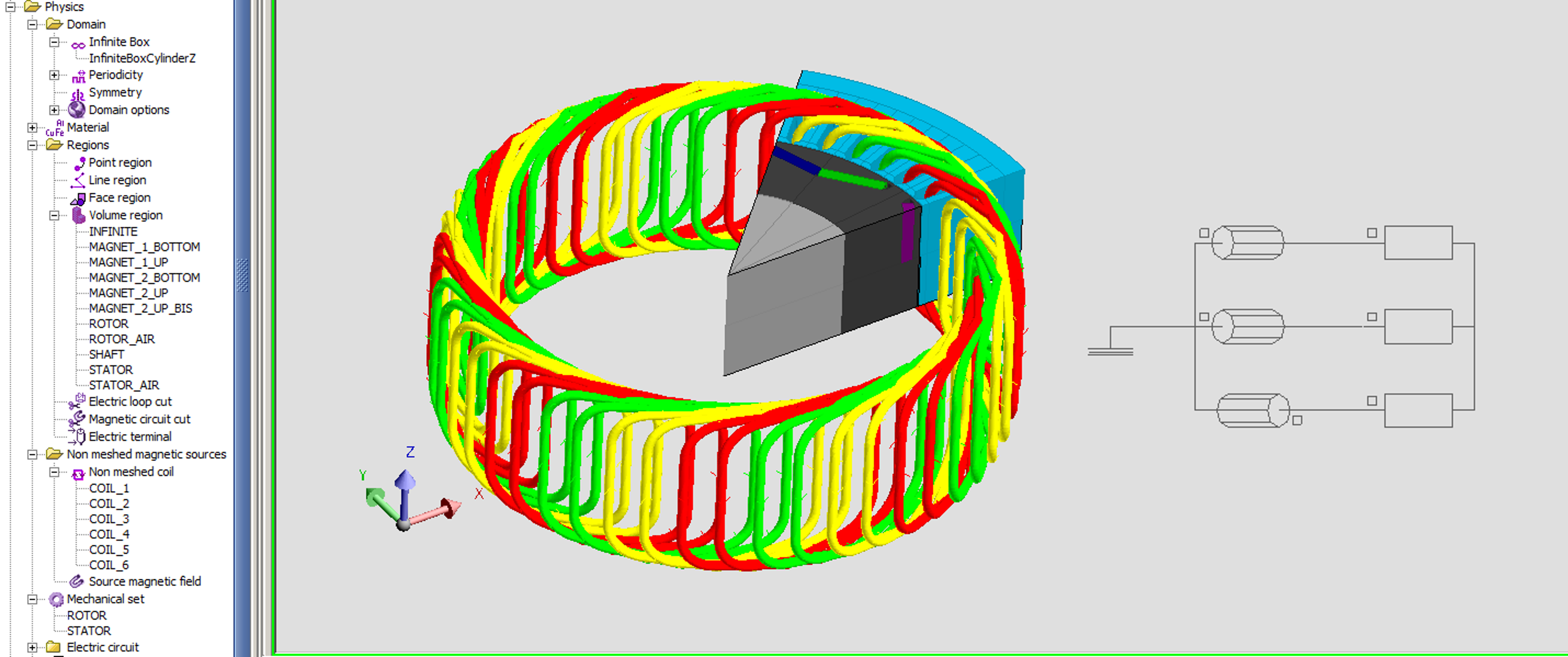

Import Flux Project in SimLab
Introduction
Since several releases, Flux teams works a lot to integrate the various applications in SimLab. The main goal of this integration are the homogenization of the easy GUI of all Altair's tools, and the easy to use to be able to do multiphysics modeling (NVH, Thermal, Electromagnetic, Electrostatic...).
To ensure a smooth transition for Flux users to SimLab, we are working to be able to import a Flux project into SimLab (via Abaqus export and import).
Since SimLab 2026, we implement a Flux project import command directly into SimLab.
Flux
SimLab
Restriction: Some restrictions due to the technological differences between Flux/SimLab:
  • Exporting a Flux project produces a “Ready to solve” project in SimLab. The Flux simulation results are not migrated into SimLab, and you will have to re-solve the project.
  • Parametrization methods are radically different between Flux and SimLab and no direct correspondence is possible. As a consequence, if a Flux project contains parametrized geometry, after the Abaqus export from Flux and the Abaqus import to SimLab, the geometric parametrization is lost (More detail in Parameters management).

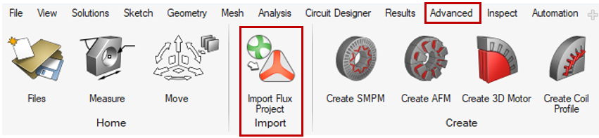

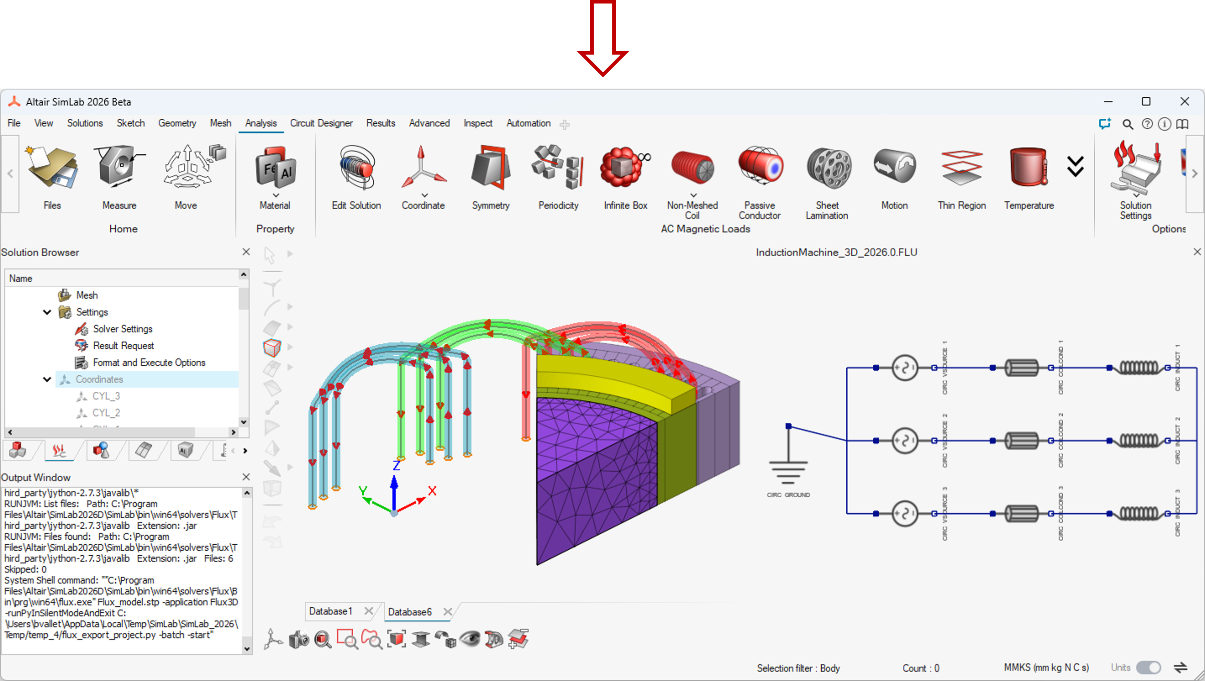

Workflow from SimLab

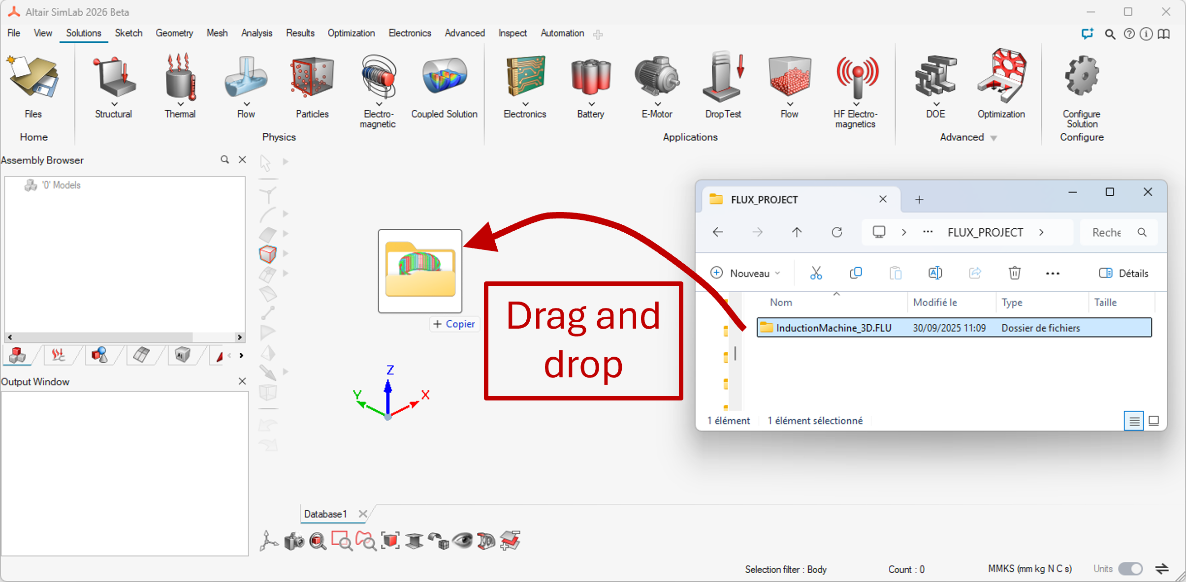

To import a Flux project directly into SimLab:
  1. Open SimLab
  2. Drag and drop the FluxProject.FLU folder in the graphic View
    Note: In background: the Flux project is exported in Abaqus file via Flux + the Abaqus file is imported in SimLab
Note: It's possible to import a Flux project by command in the menu Advanced > Electromagnetic > Import Flux project
→ Some Warnings could be displayed

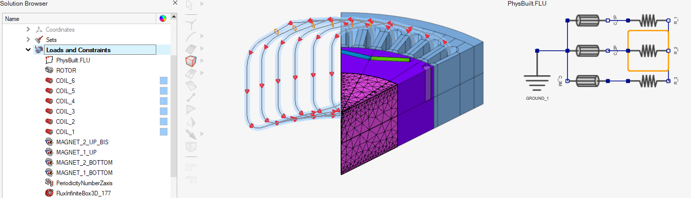

→ Flux project is imported in SimLab and the SimLab database is created with corresponding Bodies, LBC,...

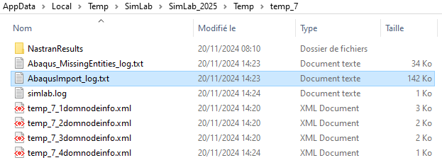

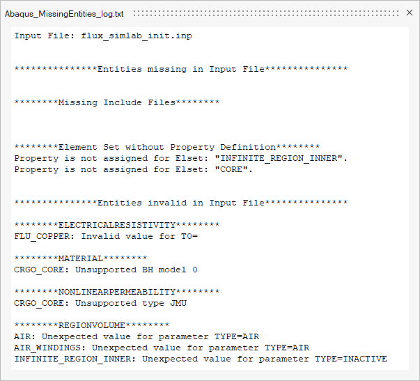

→ A log is opened with the list of missing entities and other information
→ Log file "AbaqusImport_log.txt" is stored in user scratch directory defined in SimLab Preference. By defaut it's: C:\Users\"NameOfUser"\AppData\Local\Temp\SimLab\SimLab_2025\Temp\temp_x

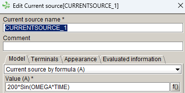

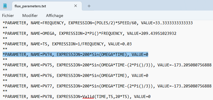

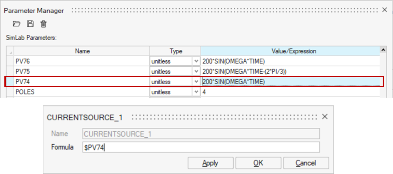

Flux project: required modifications
For compatibility reason with SimLab, when you execute the command "Export project to SimLab in Flux, some needed modifications are applied in background before the export in order to be able to convert to the corresponding SimLab database:
  • When a field is defined by a formula (which could be defined also by other parameters), a new parameter is created with the same formula and exported. The initial field is modified and filled this new intermediate parameter.
    All these intermediate parameters are listed in a txt file: ..\includes\parameters\flux_parameters.txt
    Flux project SimLab database

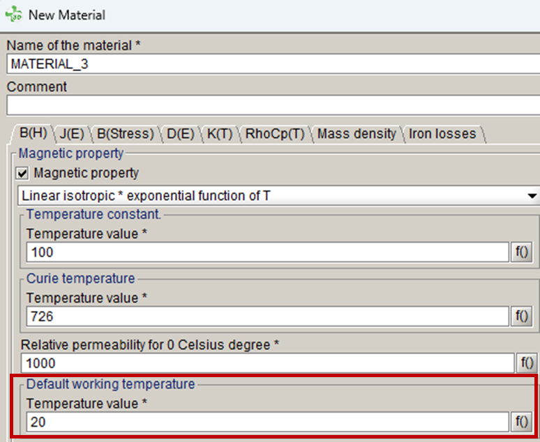

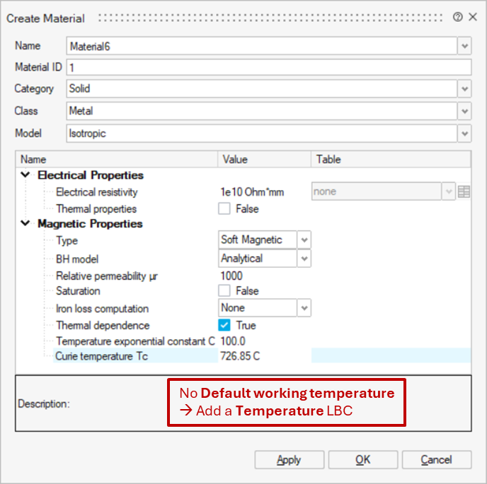

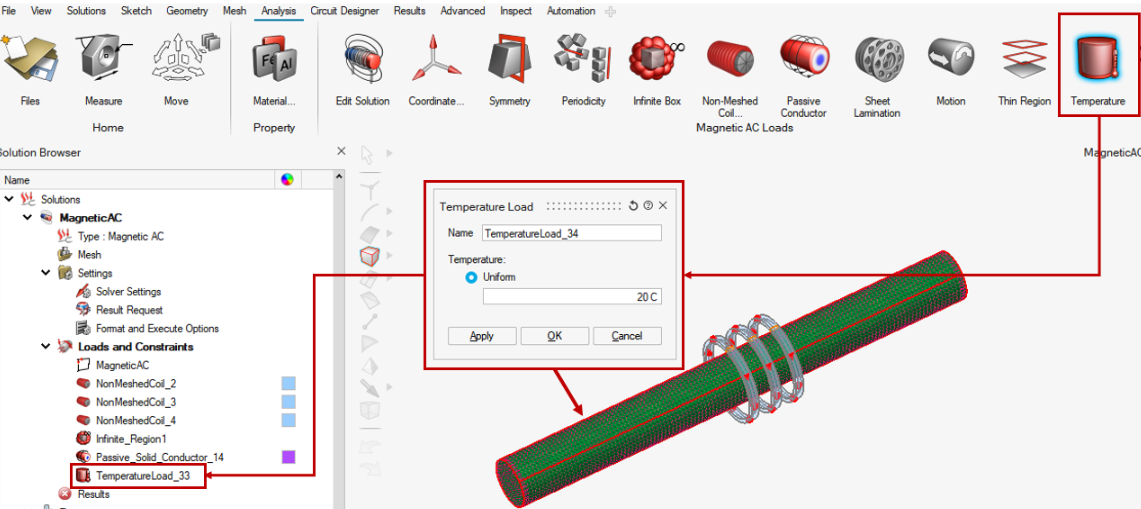

Default Working Temperature
For Thermal models, the Default working temperature is differently defined in Flux and in SimLab:
  • In Flux: the default working temperature is defined in the material model
  • In SimLab the default working temperature is not defined in the material but via the creation of an LBC called Temperature assigned to expected body/bodies. The material must be assigned to the same body /bodies to validated the thermal model.
In Flux In SimLab
