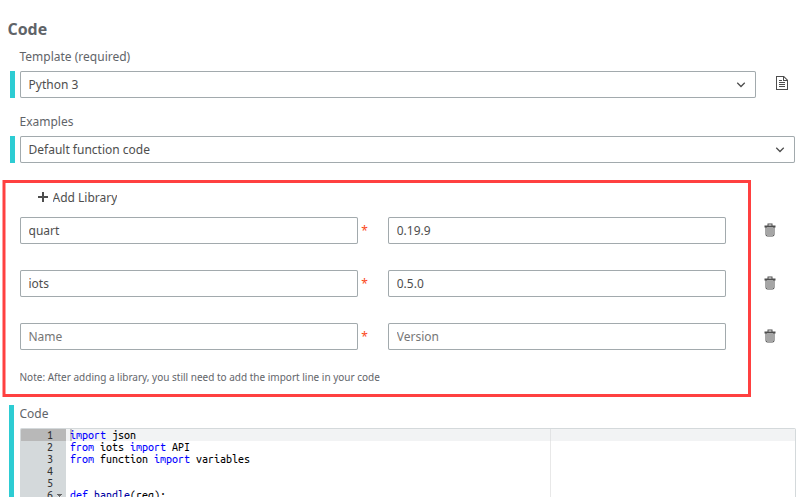

Libraries
Adding third-party Python dependencies is not allowed at the moment, although this
will change in the future. For now, you can use the Python's standard library and
the following pre-installed dependencies (this list will grow):
