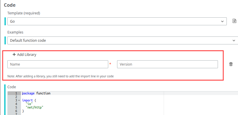

Here are few sources:Libraries
Adding third-party dependencies is not allowed at the moment, although this will
change in the future. For now, you can use the following pre-installed dependencies
(this list will grow):
