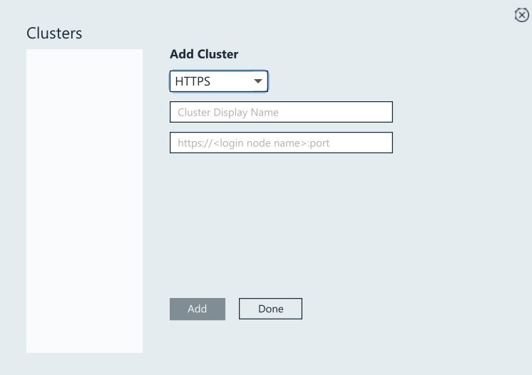

Select Clusters.
A Clusters dialog box is displayed.
Select HTTPS from the drop-down list.
Figure 1. Adding a Cluster
Enter a Cluster Display Name.
Note: You can use alphanumeric characters for a cluster display name.
Enter the Access Web URL in the format
https://<hostname>:4443. Hostname is the machine
where Access Web is installed.
Note: If a hostname is provided during the Access Web installation enter the Access Web URL using the hostname to register the HTTPS cluster. Similarly follow the same if IP address is provided.
Click Add.

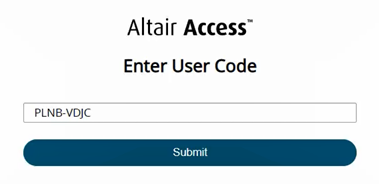

A new web browser is launched and authenticates the user using the OpenID Connect (OIDC) and provides an authenticate code.
Figure 2. OIDC Authentication to Altair Access
Click Submit.

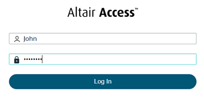

The Access login page is displayed.
Enter your credentials.
Figure 3. Access Web Login

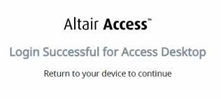

Click Log In.

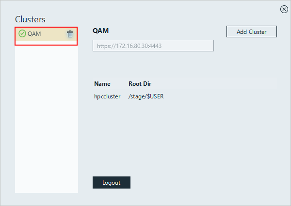

Figure 4. Successful Login to Access
Close the browser. Return to the Access Desktop application; the
cluster is added, and a green check mark is displayed next to the cluster
name.
Figure 5. HTTPS Cluster Registered to Access
