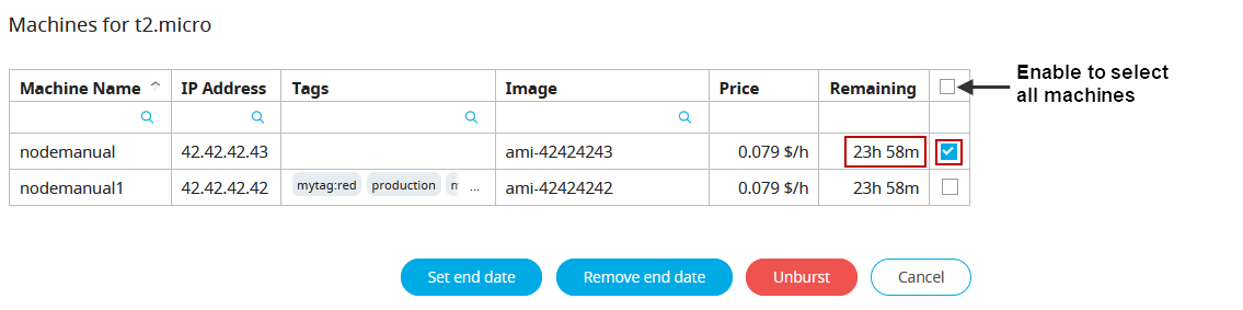

Choose the machines.
Tip: For machines that have had an end date set, the time remaining before the machine is unburst is displayed under the Remaining column.
Figure 3. Choose Machines - Click Remove end date.
Click Remove.
The end date is removed. The machine will continue to run until it is unburst manually.
