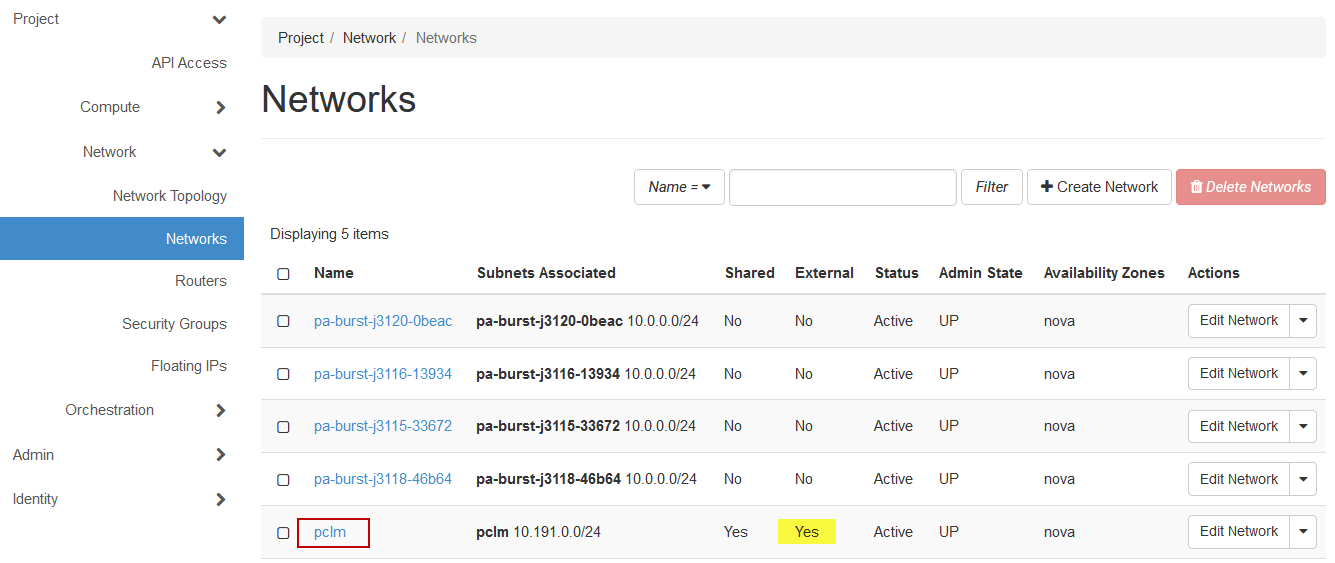

- A virtual network must be created. For more information see Create and manage networks.

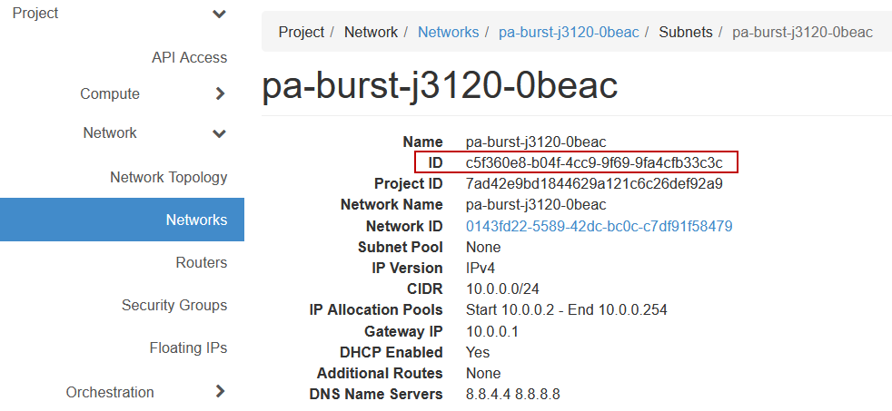

- A subnet must be created for this network. The subnet’s ID is a value that is required to be entered for the bursting scenario.

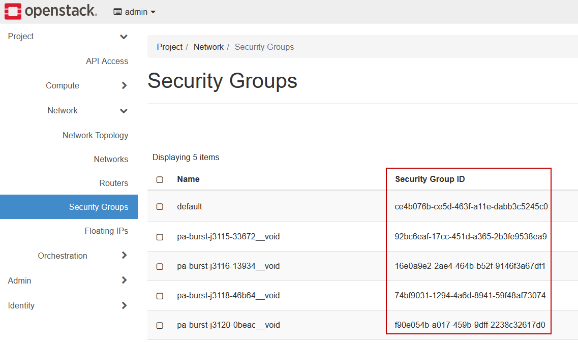

- A security group must be created. Either create a new security group or use
the default security group. The security group’s ID is necessary to create a
bursting scenario. For more information see Configure access and security for
instances.

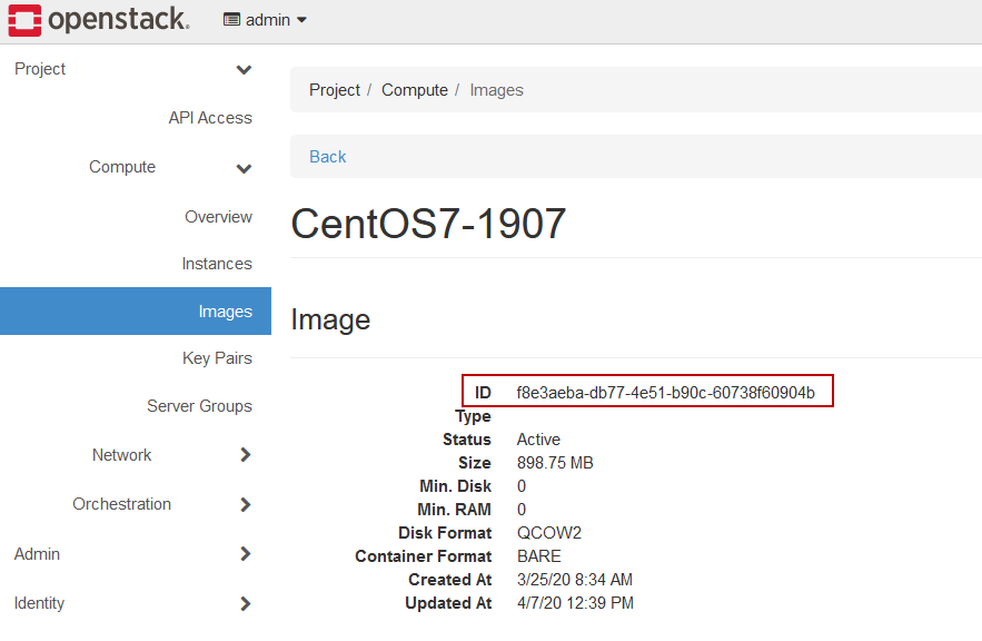

- An OS image is necessary to launch a cloud instance. For more information see OpenStack Virtual Machine Image Guide. The OS image ID is necessary for creating a cloud bursting scenario.
