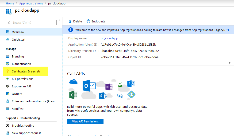

Register Control to the Azure Active Directory.
Obtain the application id of the newly registered application.
Create a client secret key for your newly registered application.

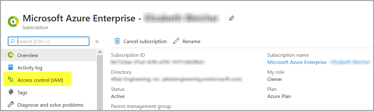

Obtain your Azure subscription ID.
Assign an access control role to the newly registered application.

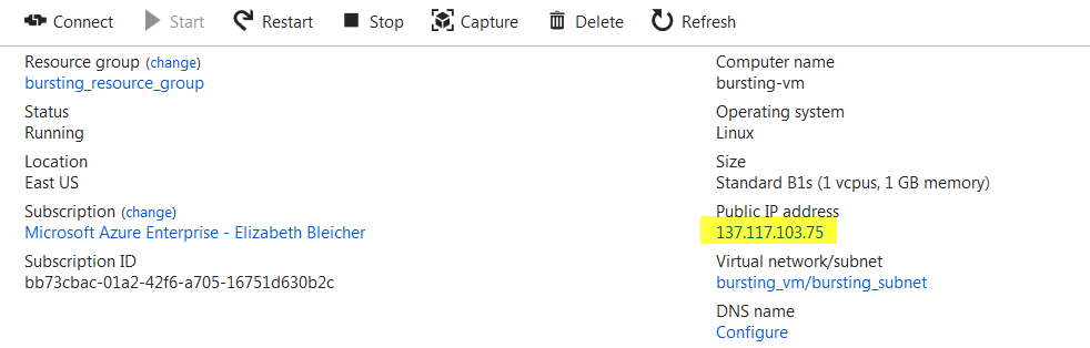

Create a Virtual Machine
Create a virtual machine in Azure.
You may want to view the following web page to learn about Azure Managed Disks before creating a VM. Additionally, a video is available from Microsoft that shows how to create a virtual machine: Create a Linux Virtual Machine.
Enter the following to configure the basic settings for the virtual machine:
Enter the following to configure the storage settings for the virtual machine:
Enter the following to configure the networking settings for the virtual machine:
