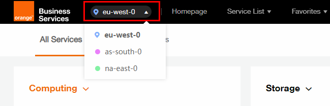

Select a Region
Define a region in the Orange Cloud Flexible Engine console to set up the infrastructure for cloud bursting.

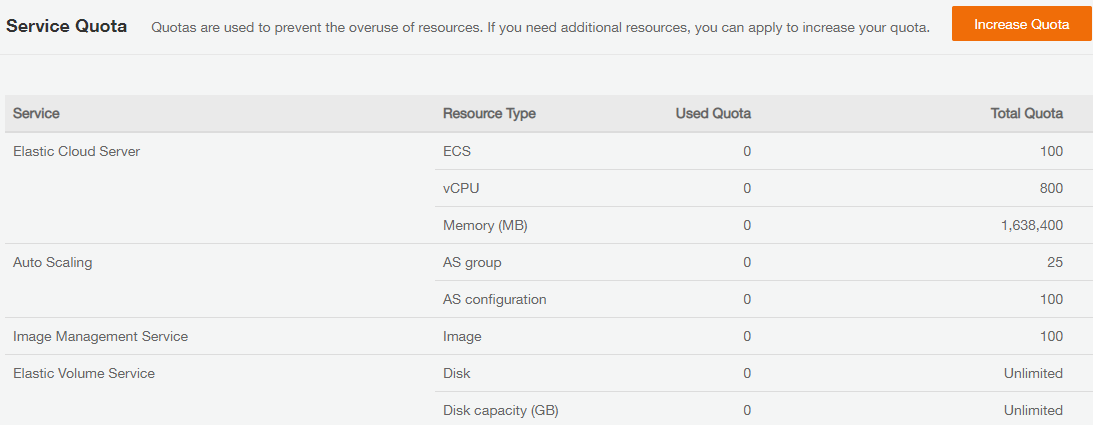

Check Orange Cloud Flexible Engine Account Service Quota
View your account resource usage and limits from the console.
Quotas are used to limit the number of resources available to users. It is important to ensure you are not exceeding your quota while setting up the resources for cloud bursting. If the existing resource quota cannot meet your service requirements, you can submit a work order to increase your quota. Once your application is approved, your resource quota is updated accordingly and you will be sent a notification.
