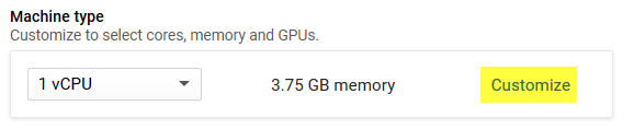

Creating a Virtual Machine
Create a CentOS 7.3 virtual Machine in GCP.
GCP documentation can be found at Virtual Machine Instances and Creating and Starting a VM Instance.

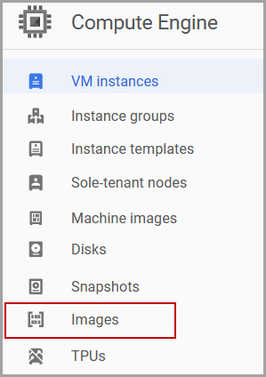

Create an OS Image
Create an image of the virtual machine configured per your site's requirements. You can choose to keep the image and use it to update your bursting image with patches, new applications etc. You can bring the instance online, patch and then recreate the image at your discretion. The saving in build and management time for the images will offset the additional storage costs.
GCP documentation can be found at Creating, Deleting, and Deprecating Custom Images.
