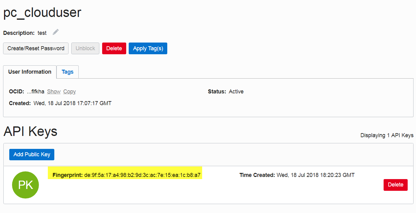

Create an Oracle Cloud User Account
Create an Oracle Cloud user account so that you can later create a cloud account in Control.
Oracle documentation can be found at Adding Users and Resource Identifiers.
- The user account's Oracle Cloud ID (OCID).
Generating an SSH Public for the Oracle Cloud User
Use OpenSSL to create a private and public key in a PEM format for the previously created Oracle Cloud user.
- The RSA public key's fingerprint.

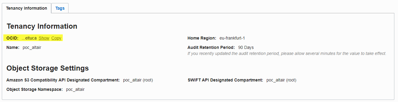

Obtain the Tenancy Identifier
Obtain the Oracle Cloud identifier of the tenancy that you can later create a cloud account in Control.
- The tenancy's Oracle Cloud ID (OCID).

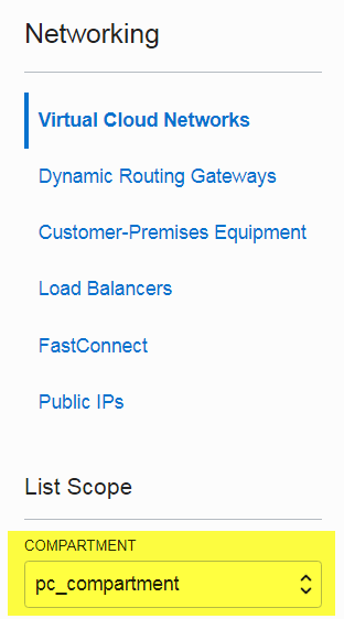

Create a Virtual Cloud Network
Create a Virtual Cloud Network (VCN) so that you can perform cloud bursting.
Oracle documentation can be found at Overview of Networking and Creating a Virtual Cloud Network.

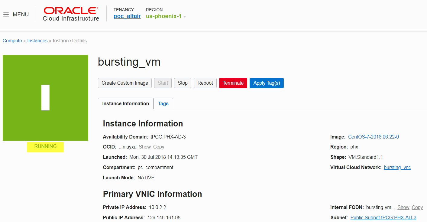

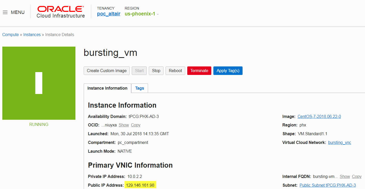

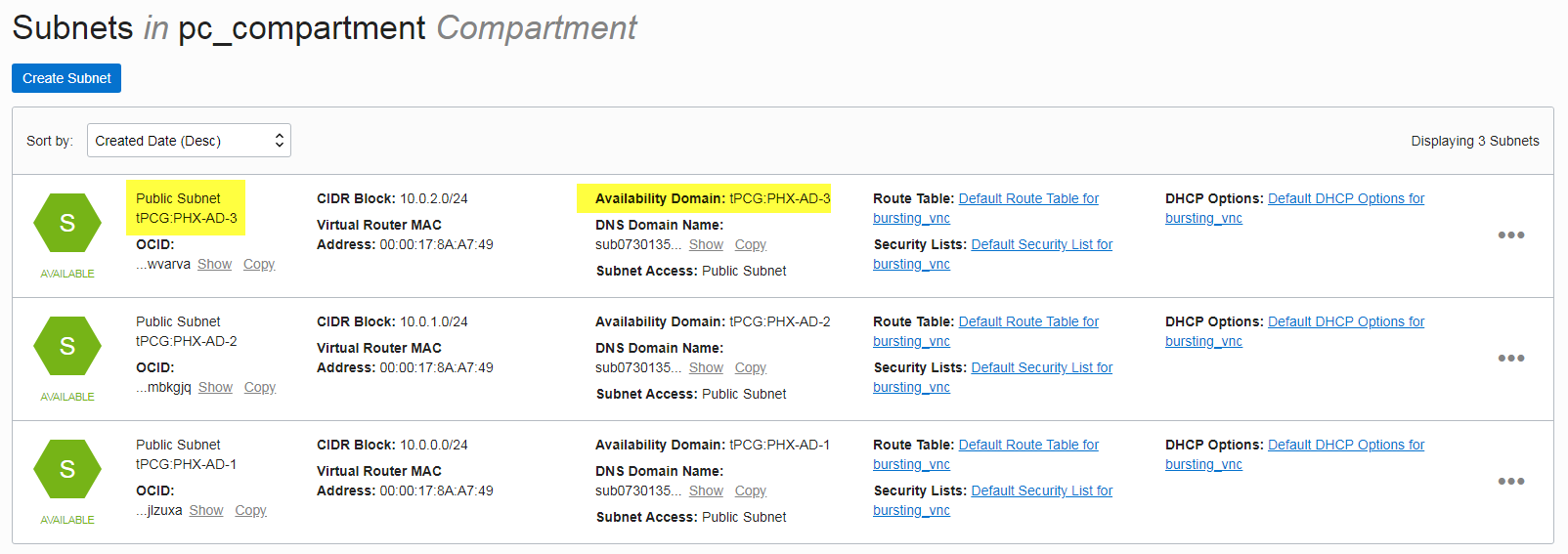

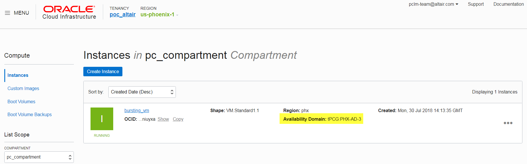

Creating a Virtual Machine
Create a CentOS 7 virtual machine (VM) in Oracle Cloud.

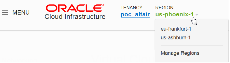

Virtual machines are hosted in availability domains (data centers) located in a region and are based on predefined VM shapes. Before proceeding, determine the VM shape that your site requires for cloud bursting based on the number of CPUs, memory, disk space, network bandwidth, and virtual network interface cards. While selecting the shape for a VM, consider the nature of the applications that you plan to deploy on the instance, the number of users that you expect to use the applications, and also how you expect the load to scale in the future. Remember to also factor in the CPU and memory resources that are necessary for the operating system.

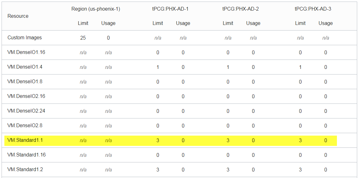

Next, verify that your Oracle tenancy has the appropriate service limits for the VM shape and the region's availability domains Check Tenancy Service Limits.
Check the service limit for your tenancy before creating the components necessary for cloud bursting.
When you sign up for Oracle Cloud Infrastructure, a set of service limits are configured for your tenancy. The service limit is the quota or allowance set on a resource. For example, your tenancy is allowed a maximum number of compute instances (virtual machines) per availability domain. These limits are generally established with your Oracle sales representative when you purchase Oracle Cloud Infrastructure. Oracle documentation can be found at Service Limits and Regions and Availability Domains.
When you reach the service limit for a resource, you receive an error when you try to create a new resource of that type. You cannot create a new resource until you are granted an increase to your service limit or you terminate an existing resource.
