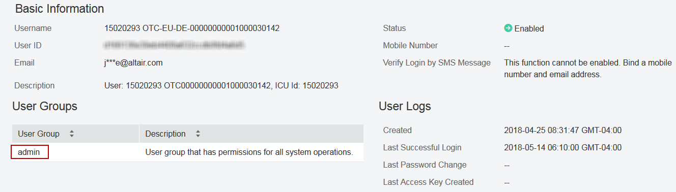

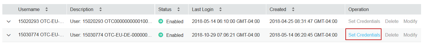

Obtain the OTC Administrator Credentials
Get the credentials for the OTC administrative user account so that you can later use this information to create a cloud account in Control.

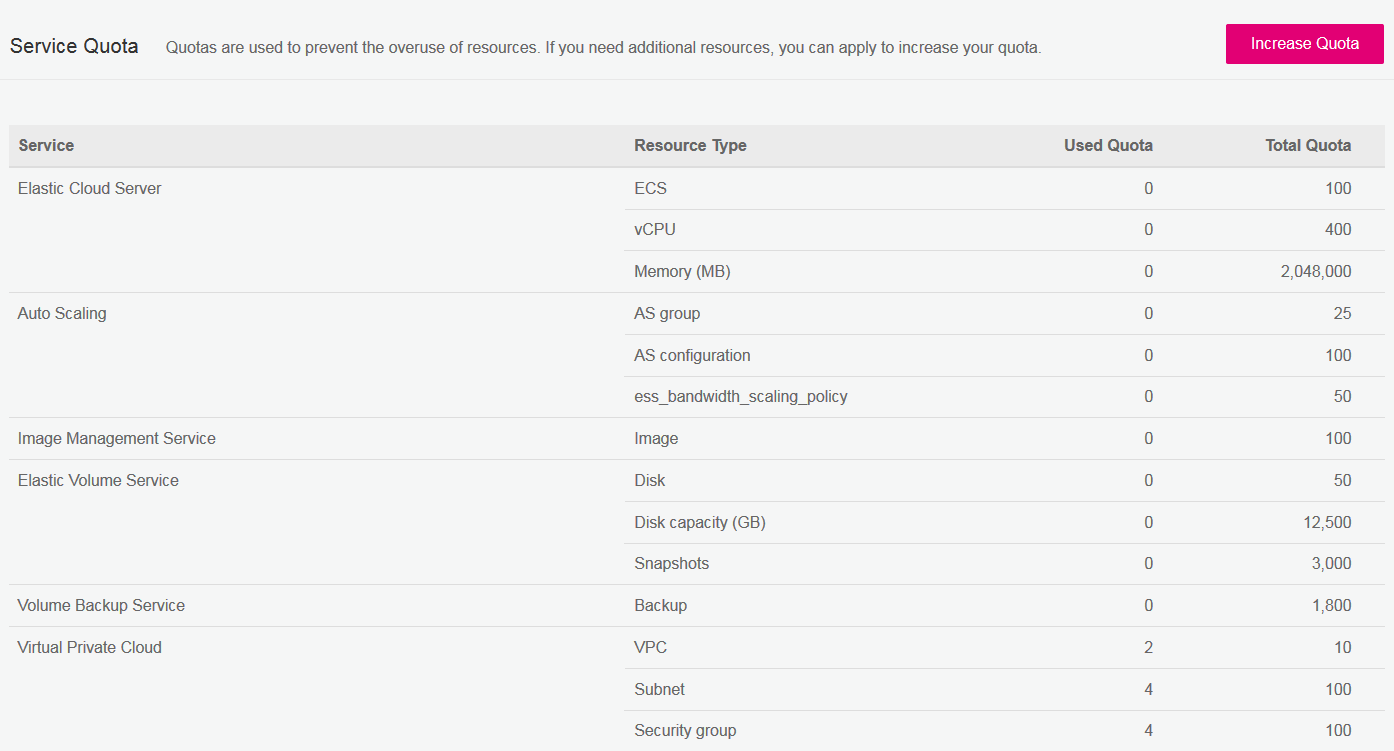

Check OTC Account Service Quotas
View your OTC account resource usage and limits.
Quotas are used to limit the number of resources available to users. It is important to ensure you are not exceeding your quota while setting up the resources for cloud bursting. If the existing resource quota cannot meet your service requirements, you can submit a work order to increase your quota. Once your application is approved, your resource quota is updated accordingly and you will be sent a notification.

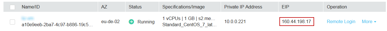

Creating a Virtual Machine
Create a Elastic Cloud Server (ECS) using a public image provided by OTC for cloud bursting.
OTC documentation for creating an ECS (virtual machine) can be found at Create an ECS.
