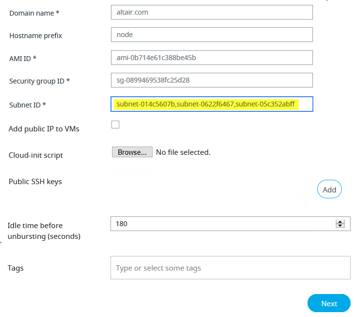

Control attempts to burst cloud nodes in the first subnet in the list. If there is no availability in that subnet, then it will attempt to burst cloud nodes in the next subnet in the list and will continue until a subnet is found where the cloud nodes can be burst or until all subnets are exhausted (i.e. bursting fails). The cloud bursting hook attempts to burst all requested cloud nodes in a single subnet. Cloud nodes are not burst across subnets. This same process is followed each bursting cycle until there is availability for the cloud nodes.
Example
10 cloud nodes are requested for bursting.
- The cloud bursting hook attempts to burst all 10 nodes in subnet-014c5607b.
- If there is no availability in subnet-014c5607b, the hook attempts to burst all 10 cloud nodes in subnet-0622f6467.
- If there is no availability in subnet-0622f6467, the hook attempts to burst all 10 cloud nodes in subnet-05c352abff.
- If there is no availability in subnet-05c352abff, then cloud bursting fails.

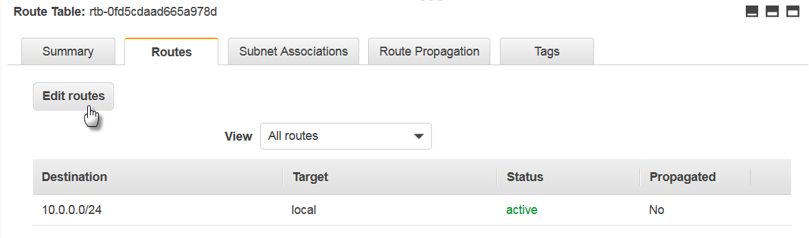

Create and Edit the VPC Route Table
Add a rule to the VPC route table that allows all internet access and associate the route table to the bursting subnet.
Add a rule that allows all traffic access to the internet gateway:
Associated the route table to the bursting subnet:

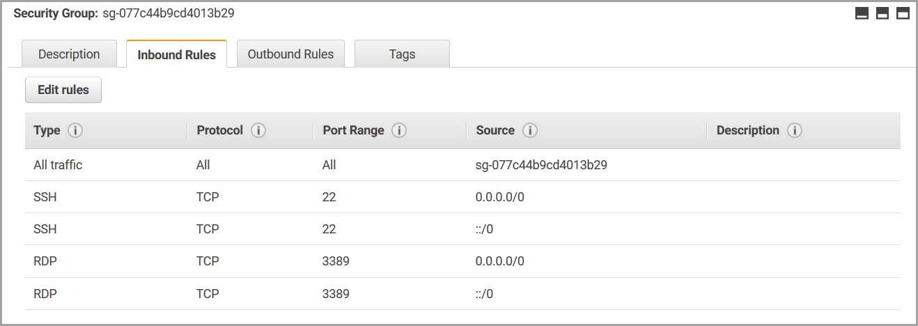

Add Inbound Rules to the VPC Security Group
Add inbound rules to the VPC security group so that a connection can be established with an AWS VM using SSH or RDP.

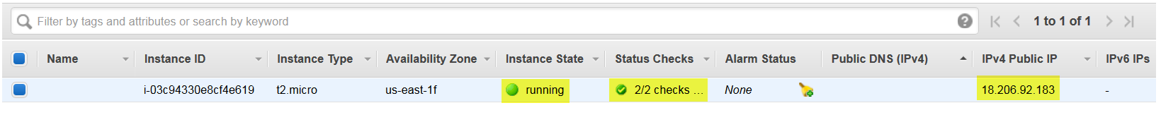

Create a Virtual Machine
Create a virtual machine in AWS Elastic Compute Cloud (EC2).
Figure 5. Bursting Virtual Machine

Create an AWS Cloud Bursting Scenario
Create an AWS bursting scenario so that PBS Professional execution nodes can be burst in the cloud.
A startup script is provided during the creation of the bursting scenario. This script is ran after a cloud node is burst and is used to set up the system environment so that nodes burst in the cloud can communicate with the PBS Server. On Windows platforms, the startup script must be a PowerShell script. For more information see PowerShell Scripting. On Linux platforms, use a cloud-init script. For more information about writing cloud-init scripts, refer to the Cloudinit Documentation and Cloud Bursting Startup Script.
