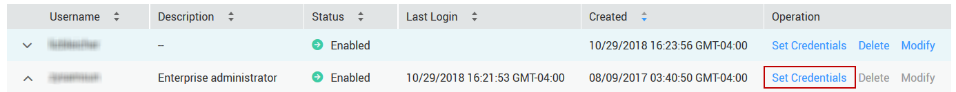

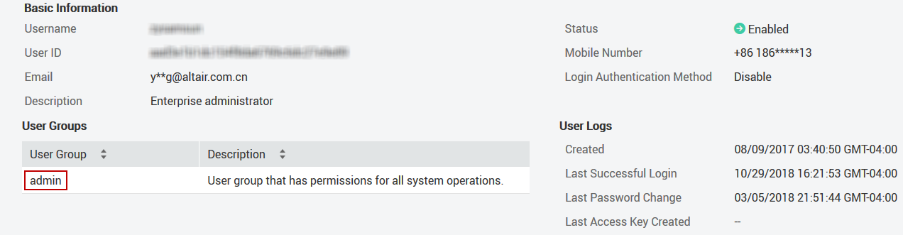

Obtain the HUAWEI Cloud Administrator Credentials
Get the credentials for the HUAWEI Cloud administrative user account so that you can later use this information to create a cloud account in Control.

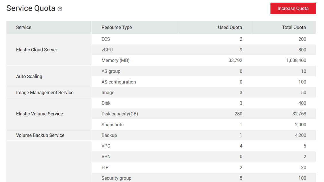

Check HUAWEI Cloud Account Service Quotas
View your account resource usage and limits.
Quotas are used to limit the number of resources available to users. It is important to ensure you are not exceeding your quota while setting up the resources for cloud bursting. If the existing resource quota cannot meet your service requirements, you can submit a work order to increase your quota. Once your application is approved, your resource quota is updated accordingly and you will be sent a notification.

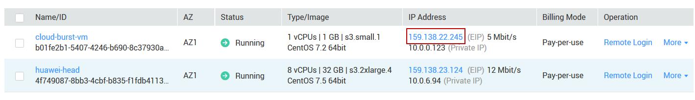

Creating a Virtual Machine
Create a Elastic Cloud Server (ECS) using a public image provided by HUAWEI Cloud for cloud bursting.
HUAWEI Cloud documentation for creating an ECS (virtual machine) can be found at Purchase an ECS.
Installing and Configuring the PBS MoM on the VM
Install the PBS MoM on the virtual machine and configure the VM per your site's environment.
