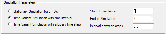

The rest of the workflow is similar to the regular propagation simulations. You can specify
the time samples of interest from the menu Project > Edit Project Parameter > Simulation tab.
Figure 4. Specifying the time samples of interest in ProMan
for the movement that had been defined in WallMan.
