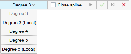

  3. Optional: In the guide bar, select a curve degree. This controls the placement of the points to determine the shape of the curve.
    • Degree 3: Create a degree 3 curve. Modifying a point on the curve can affect the entire curve.
    • Degree 3 (Local): Create a degree 3 curve with local interpolation. Modifying a point on the curve affects only the sections of the curve adjacent to that point.
    • Degree 5: Create a degree 5 curve. In general, select this option to produce a smoother curve. Modifying a point on the curve can affect the entire curve.
    • Degree 5 (Local): Create a degree 5 curve with local interpolation. In general, select this option to produce a smoother curve. Modifying a point on the curve affects only the sections of the curve adjacent to that point.

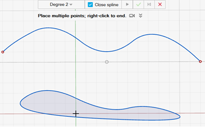

  4. Optional: In the guide bar, select a Close spline to close the spline when it is created. In the following example, the top spline was created with Close spline unselected, and the bottom spline was created with Close spline selected.

    Define the degree In the guide bar, select from:
    • Degree 2
    • Degree 3
    • Degree 3 (Local)
    • Degree 4
    • Degree 5
    • Degree 5 (Local)
    Note: Higher degree settings result in smoother curves.

    Close the spline on creation In the guide bar, turn on Close spline.

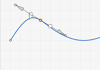

    Change the tangency Drag the diamond control to adjust the tangent curve:
    Note: Available only for splines created with the Spline Through Points tool .

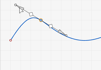

    Change the magnitude Drag from the arrowhead at either end of the tangent line:

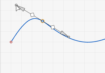

    Change the tangency and magnitude simultaneously Drag the point at either end of the tangent line:
