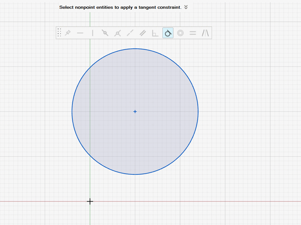

  1. In sketch mode, select the entities you want to constrain.
  2. Select or deselect an icon on the Constraint Toolbar. When a constraint is selected, it allows you to quickly select entities in the sketch to apply constraints.

    Tangent
    Click a line and a circle/arc (or two circles/arcs) to constrain them to be tangent to each other.
