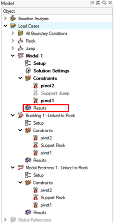

All of the loads and supports, displacements, accelerations, and temperatures in a model are shown in the Model Browser in a folder called All Boundary Conditions. (This folder only appears once a load or support has been applied to the model.) The folders for each load case list only those that are active for the particular load case.

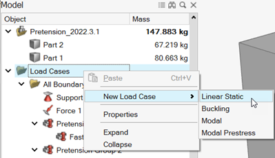

You can create load cases and assign individual loads, supports, etc. to each using the right-click context menu. Any load or displacement can be included in multiple load cases, and therefore may appear multiple times in the Model Browser.

To Do this Note Create a load case Right-click a load or displacement, and then select New Load Case.
The new load case is automatically made the current load case and the Structural or Modal tool is displayed. For more information, see Structural Load Cases or Modal Load Cases. Set the current load case Right-click a load case, and then click Current. The current load case is show in bold. When you create a new load or displacement, it is automatically assigned to the current load case. Rename a load case - Click a selected load case and then type a new name.
 - Right-click a load case, and then click Rename.
Isolate a load case Right-click a load case, and then click Isolate Loads and Parts. This option will isolate all loads and parts in the selected load case in the modeling window, hiding all others. Delete a load case Right-click a load case, and then click Delete. If you delete a load or displacement, it disappears from every load case and the All Boundary Conditions folder. Copy and paste a load case Right-click a load case, and then click Copy. Right-click again, and then click Paste.
Set up or edit a load case Double-click Setup
 in a load
                                        case folder.The Structural or Modal tool is displayed. Note: You can also create analyses in the Load Cases Table.

You can use the Model Browser context menu to include or exclude entities from load cases.
- Press F2 to open the Model Browser.
                Right-click a load or support, and then click .
Figure 2. Model Browser Context Menu
