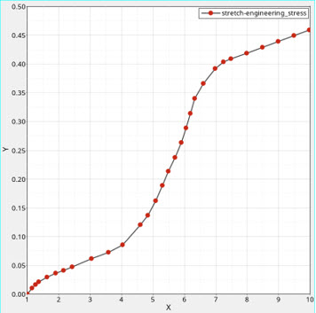

Figure 3. Experimental uniaxial tensile stress-stretch curve
Tensile input data covers engineering stress up to 0.46 MPa and since the design load corresponds to nominal stress of 0.5 MPa, extrapolation is used at the end of the NLSTAT LGDISP load step.

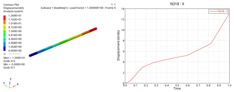

Results
The peak deformation in uniaxial tensile test of hyperelastic material with CHEXA element is 13.09 mm.
Figure 5. Deformation of CHEXA element due to tensile forces

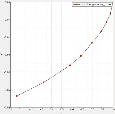

Figure 7. Experimental compressive stress-stretch curve
In compression, stretch can be defined as 0 < λ 1 MathType@MTEF@5@5@+= feaagKart1ev2aaatCvAUfeBSjuyZL2yd9gzLbvyNv2CaerbuLwBLn hiov2DGi1BTfMBaeXatLxBI9gBaerbd9wDYLwzYbItLDharqqtubsr 4rNCHbGeaGqipu0Je9sqqrpepC0xbbL8F4rqqrFfpeea0xe9Lq=Jc9 vqaqpepm0xbba9pwe9Q8fs0=yqaqpepae9pg0FirpepeKkFr0xfr=x fr=xb9adbaqaaeGaciGaaiaabeqaamaabaabaaGcbaGaaGimaiabgY da8iabeU7aSjabgsMiJkaaigdaaaa@3BB8@ and the deformation of the model stays in the specified range.

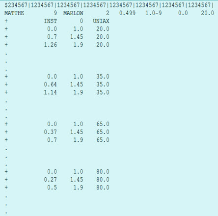

MATTHE is used to define temperature dependent hyperelastic materials. MATTHE is supported in implicit LGDISP analysis. Experimental engineering stress-stretch data at each temperature is presented in tabular format in ascending order.
Figure 9. Experimental stress-stretch curve at each temperature
Figure 10. Specify the MATTHE Marlow material model
While defining Marlow material model in OptiStruct, when volumetric behavior is temperature independent, the 1st column corresponds to nominal stress, 2nd to stretch and 3rd to temperature. In this case, either nu (or D1) defines the constant volumetric response throughout the deformation.

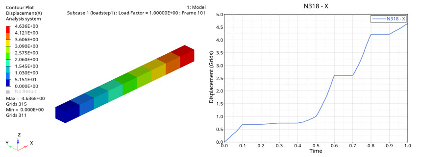

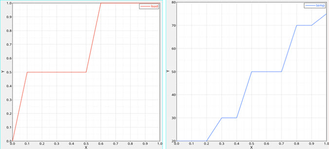

Figure 11. Mechanical load (left) and Thermal load (right) applied on CHEXA element
The example model contains two TLOAD1s that define mechanical and thermal load profiles that evolve in different phases and those are combined with DLOAD.
Results
Hyperelastic MATTHE Marlow model of CHEXA element shows peak displacement of 4.636 mm in x-direction.
Figure 12. Deformation of CHEXA element. displacement in loading direction

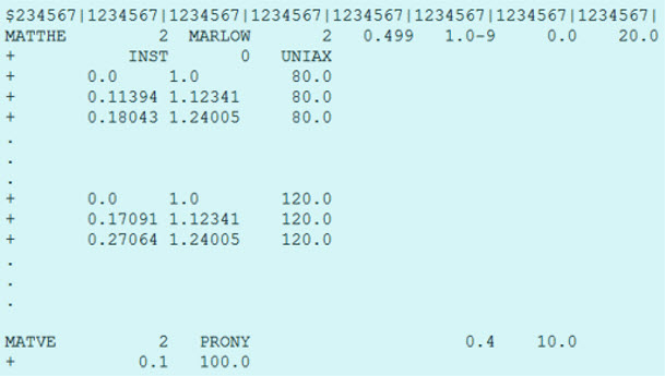

When viscoelasticity is considered, moduli temporal property needs to be specified in the continuation line of MATHE card. By default, this is considered as long-term relaxed input. The other options are to specify it as instantaneous input. MATVE card has the same ID as MATHE.
Figure 13. MATHE + MATVE card specification with same ID for visco-hyperelastic model

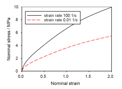

According to the definition of the visco-hyperelastic model, it requires to specify the parameters of the Prony series as well as to specify the temporal (here instantaneous) hyperelastic response by the potential U0. It is the response that the model shows on a timescale much smaller than the lowest considered relaxation time. This timescale lies outside the validity range of the model, so U0 does not have the physical meaning of the high frequency limit of the real material behavior. Nevertheless, U0 must be identified from experimental data to specify the model. It is basically a transformation from a uniaxial stress–strain curve at constant strain rate to the curve describing the instantaneous hyperelastic response.
Figure 14. Instantaneous stress-strain curve (left) and the corresponding stress-stretch curve for the MATHE card (right)
The red dashed curve is the instantaneous stress–strain curve of the viscoelastic Marlow model. The example model takes the stress-stretch data as instantaneous definition for MATHE and uses Prony series to define viscoelastic behavior.

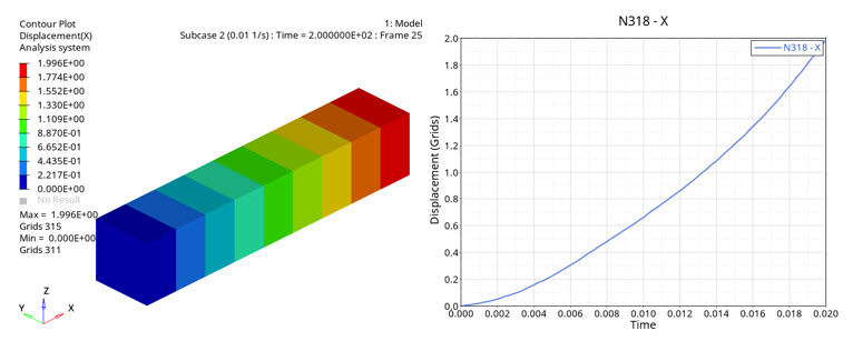

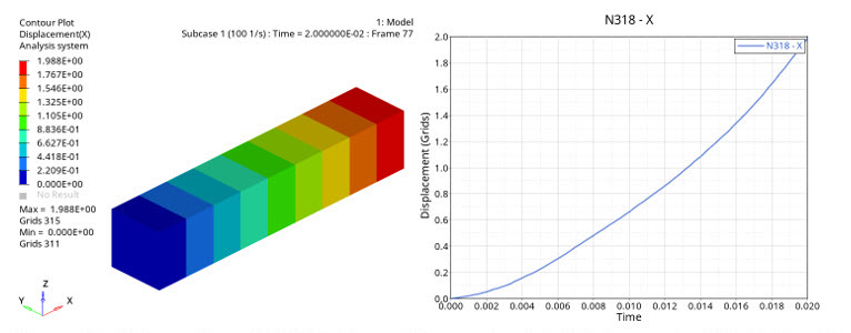

Figure 15. Two loadsteps with different loads and loading rates
Single element model is uniaxially loaded from zero to nominal stress. First loadstep having 10.0 MPa of nominal stress ramped within 0.02s (left) and second loadstep with 5.5 MPa of nominal stress ramped within 200s (right).
Results
Both load steps return the same displacement of 2 mm at the end of the nonlinear transient analysis. Nominal strain matches with reference result.
Figure 16. Deformation of CHEXA element from unloaded state to nominal 10.0 MPa within 0.02s
Figure 17. Deformation of CHEXA element from unloaded state to nominal 5.5 MPa within 200s

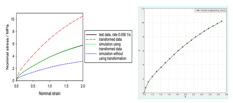

Figure 18. Reference results

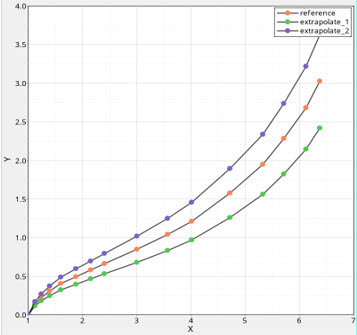

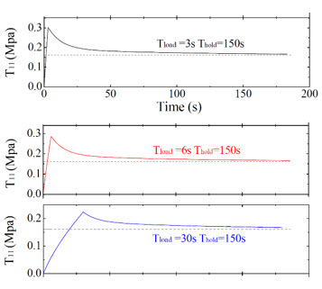

The example models take the widely referred Treloar’s stress-stretch data as reference and this is considered to return the baseline solution at T=100°C. Stress values are multiplied by factors 0.8 and 1.2 to obtain stress-stretch data at two extrapolated environments.
Figure 21. Stress-stretch data of the material

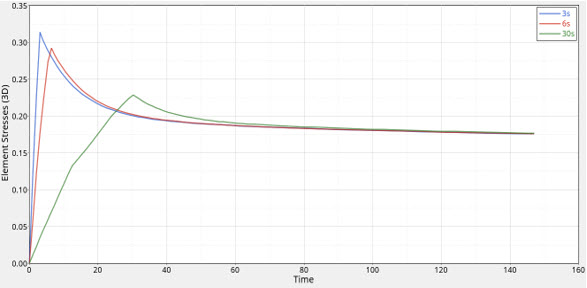

Figure 22. Reference result with 3s, 6s and 30s Tload
The uniaxial tension data at the two extrapolated environments is used as the input data.
Results
MATTHE with MARLOW + VE returns a good match for stress relaxation against the published results. In the reference study OGDEN MATHE was used (single environment). OptiStruct MATHE(OGDEN) +VE perfectly matches the simulation results shown in the reference.
Figure 23. Elemental stresses with 3s, 6s, and 30s Tload
1 Transformation of Test Data for the Specification of a Viscoelastic Marlow Model. Olaf Hesebeck, Fraunhofer Institute for Manufacturing Technology and Advanced Materials IFAM, Wiener Straße 12, 28359 Bremen, Germany.
2 Parameter Identification Methods for Hyperelastic and Hyper-Viscoelastic Models. Yifeng Wu, Hao Wang, and Aiqun Li. School of Civil Engineering, Southeast University, Nanjing 210096, China, Beijing University of Civil Engineering and Architecture, Beijing 100044, China
