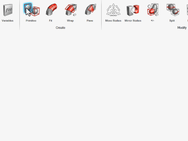

Use the Primitive tools to create a single PolyNURBS solid or surface, either around a selected object or as the starting point for a new model. This is the tool you should start with if you want to build PolyNURBS geometry without wrapping or paving.

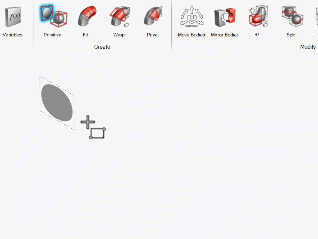

Create a PolyNURBS Surface
Create a 2D PolyNURBS surface in space or around a surface part.
On the PolyNURBS ribbon, select the PolyNURBS Surface
tool.
Tip: To find and open a tool, press Ctrl+F. For more information, see Find and Search for Tools. - Click and drag to create the PolyNURBS cage.
- Edit the PolyNURBS as needed. Right-click and mouse through the check mark to exit, or double-right-click.
