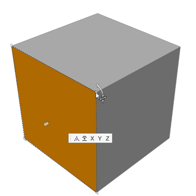

Rotate a selected face about its center
When you select a face, a curved arrow appears when you
hover over a corner or an edge. Figure 1. Hover over a cornerFigure 2. Hover over an edgeDrag the curved arrow to rotate the face about its
center.
