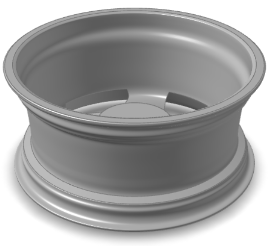

  1. From the menu bar, select File > Open.
  2. Browse to your working directory, select lowpressure.x_b, and click Open.
    The model opens in the modeling window.

    We can see how fluid is rising from the stalk to reach the wheel rim. This is the real simulation of the fluid inside the machine.
