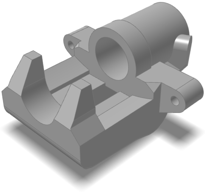

Designate a Casting Part
Select casting geometries with the Cast Part tool.
Important: A cast part must be defined before performing any other operation.
  1. On the Cast Part icon, click Designate Casting Part.
  2. Left-click to select which candidate is a cast part.
    Parts are automatically detected and highlighted based on your cursor position.
    The selected part is highlighted red.
  3. In the microdialog, select Steel as the material and select AISIF91 as the alloy for the part.
  4. Right-click and mouse through the check mark to exit, or double-right-click.

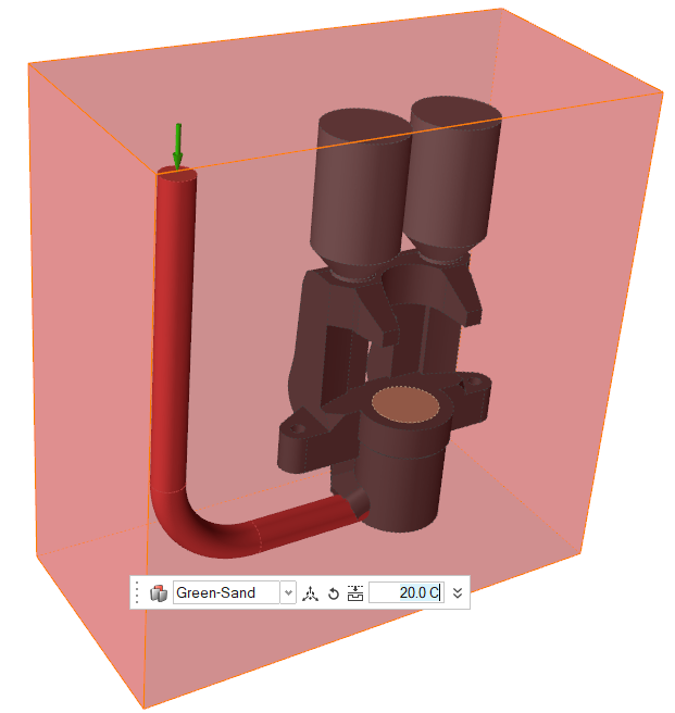

Design the Filling System
  1. Select the gate and press Delete.
  2. Click the Sketch tab.
  3. On the Circles icon, click Circle by Center and Point.
  4. Click the surface to create the sketch plane.
  5. Click on the surface shown and drag to create a circle with a diameter of 18 mm.
  6. Click the Geometry tab.
  7. Select the Push/Pull Faces tool.
  8. Select the circle we just created and pull it to a length of 70 mm.
  9. In the microdialog, ensure that Create New Part is selected.
  10. Click Apply.
Reposition the Cylinder
  1. In the Home ribbon, Click the Move icon.
  2. Select the cylinder.
  3. Click on the center of the end of the cylinder and drag the cylinder to the center of the surface where we had previously created the ingate.
  4. Select the Z arrow and move the cylinder along the Z axis 60mm.
Rotate the Axis
  1. Create a reference axis.
    1. Click Reference Axes.
    2. In the microdialog, select Through Two Planes from the dropdown menu.
    3. Select the end of the cylinder and the top surface of the flange, as shown in the image below.
    4. Click Apply .
  2. Under the Extrude icon, click Revolve Face.
  3. Select the end surface of the cylinder to revolve.
  4. Select the reference axis as the rotation axis.
  5. Rotate the surface 90°.
  6. Ensure that Combine is selected.
  7. Click Apply.
Pull the Surface
  1. Click the Push/Pull icon.
  2. Select the cylinder's surface. In the microdialog, click Create New Part.
  3. Pull the surface until the new cylinder reaches 170mm long.
  4. Click Apply.
Create an Inlet
  1. Click the Casting tab.
  2. On the Cast Part icon, click Designate Filling System.
  3. Select the geometry we just designed.
  4. On the the Gate icon, click Designate Surfaces as Gates.
  5. Select the top surface of the filling system to create the inlet.
Create a Riser
  1. Click the Components icon.
  2. On the Riser icon, click Add/Edit Riser.
  3. Click on the region where there were issues with porosity.
  4. Change the Modulus to 0.8 cm.
  5. Repeat these steps to create a second riser.
Re-create the Mold
  1. In the modeling window, select the mold component.
  2. On your keyboard, press the Delete key.
  3. In the Components subribbon, click the Mold tool.
  4. In the microdialog, select Green-Sand as the mold's material and set its initial temperature to 20 degrees C.
  5. Right-click and mouse through the check mark to exit, or double-right-click.

  3. Set the percentage to 100%.
Note: The porosity has moved from the top of the part to the risers. The risers, filling system, and core will be removed after casting, and the part will be nearly free of defects.
