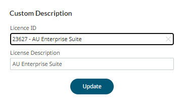

    Figure 1. License Priority
    License Priority
  2. Hold and move the row level up or down to change the license priority.
  3. Optional: Select License ID from the drop-down list to add custom description for the licenses.
  4. In License Description, add custom description for the license.
  5. Click Update.
    The license description is updated.
