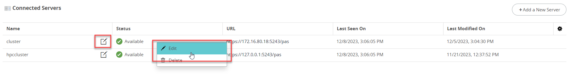

A list of server clusters that have been previously added is displayed.Figure 1. Manage Servers
To edit a server, choose one of the following options:
- Right-click the cluster and select Edit from the context menu.
- Click
next to the cluster.
Figure 2. Cluster Edit Option

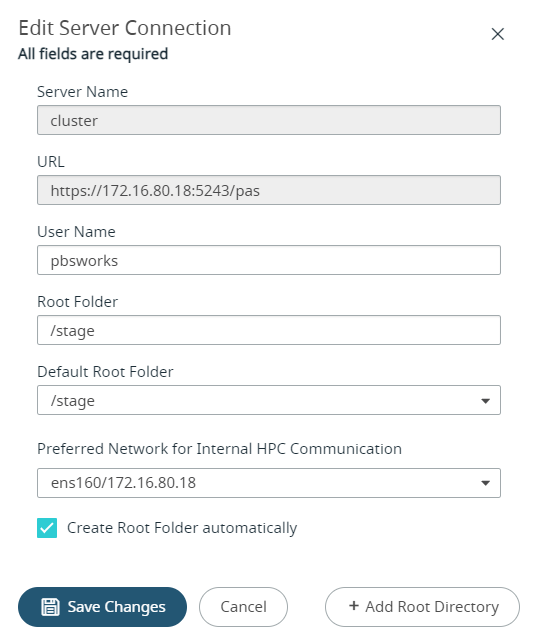

The Edit Server Cluster screen is displayed.Figure 3. Edit Server Cluster
- Update the server cluster information.
Click Save Changes.
