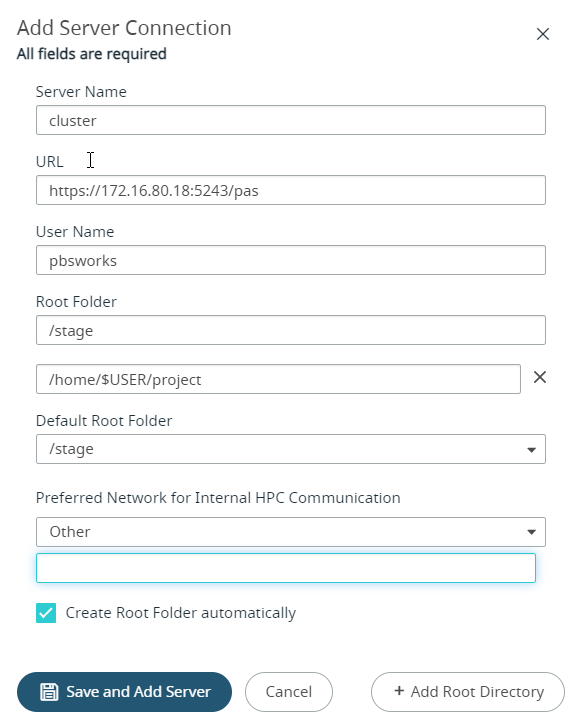

The Add Server Connection screen is displayed.Figure 1. Add Server Connection
- For Server Name, enter a short name describing the cluster.
For URL, enter the URL for connecting to the Workload
Manager.
The URL is in the format https://<hostname>:5243/pas where <hostname> is the hostname of the machine where the PAS Server is installed.Note: Add a server cluster using the PAS Server's hostname rather than the IP address. This avoids connectivity issues when an IP address is changed (DHCP, etc.).
For User Name, enter your login credential.
The user account must be available on the PAS Server.
For Root Folder, enter the pathname where user job input
and result files are stored.
Ex: /home, /users, /stage, /stage/$USER, /home/$USER/project, C:/stage, C:/Users, C:/%HOMEPATH%, C:/%HOMEPATH%/projectNote: To enable the home button for all users, add the parent directory of their home directory during server registration.
Click
if you want to add another root
directory and enter its path.
Figure 2. Adding Multiple Root Directories
Select the default root directory to be displayed from the Default
Root Folder drop-down menu.
Figure 3. Default Root Folder
By default, the Create Root Folder automatically option is set to true, which causes PAS to create the specified root directory if it does not exist.. -

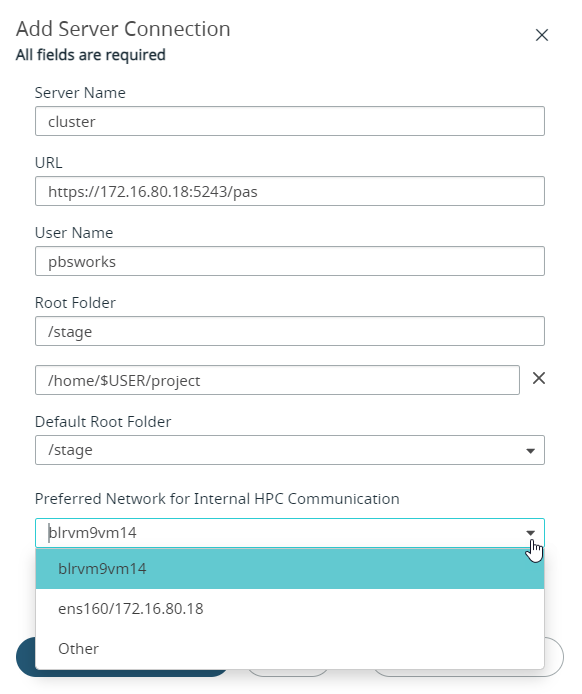

Select the network for communication between PAS
and execution nodes to the Access Web portal from
Preferred Network for Internal HPC Communication
drop-down menu.
Figure 4. Preferred Network for Internal HPC Communication
Note: Select Other from the Preferred Network for Internal HPC Communication drop-down menu to provide an alias network name.Figure 5. Preferred Network for Internal HPC Communication - Other
Click Save and Add Server.

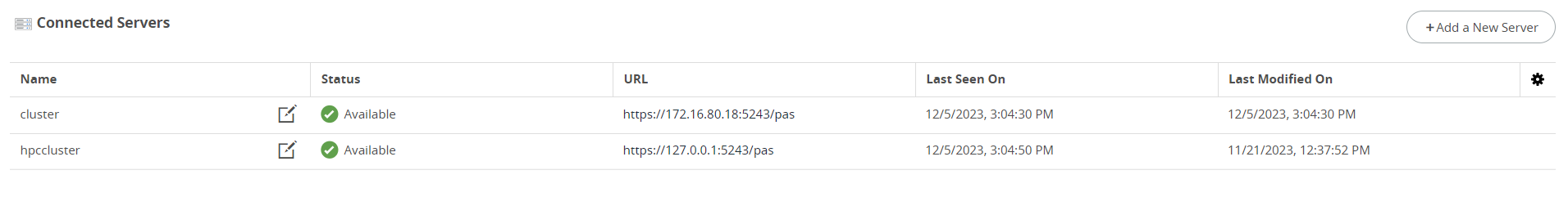

A notification is displayed when the server cluster is added.Note: A notification is displayed to all users logged into Access Web when a server cluster is added, edited, deleted, disconnected or unreachable.A list of server clusters that have been added is displayed.
Figure 6. Server Clusters List
When a server cluster is unavailable, the Status column explains why. To view the error message, hover your mouse over the Status column of a server cluster.
