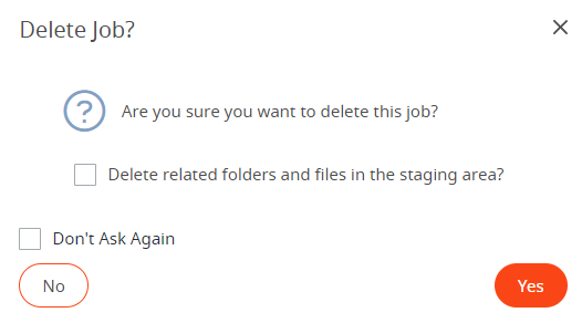

The Delete Job dialog box is displayed.
Figure 1. Delete Job
Perform one of the following options:
- Click Yes to remove the job.
- Select Delete related folders and files in the staging area? check box and click Yes to remove the job from the staging area.
