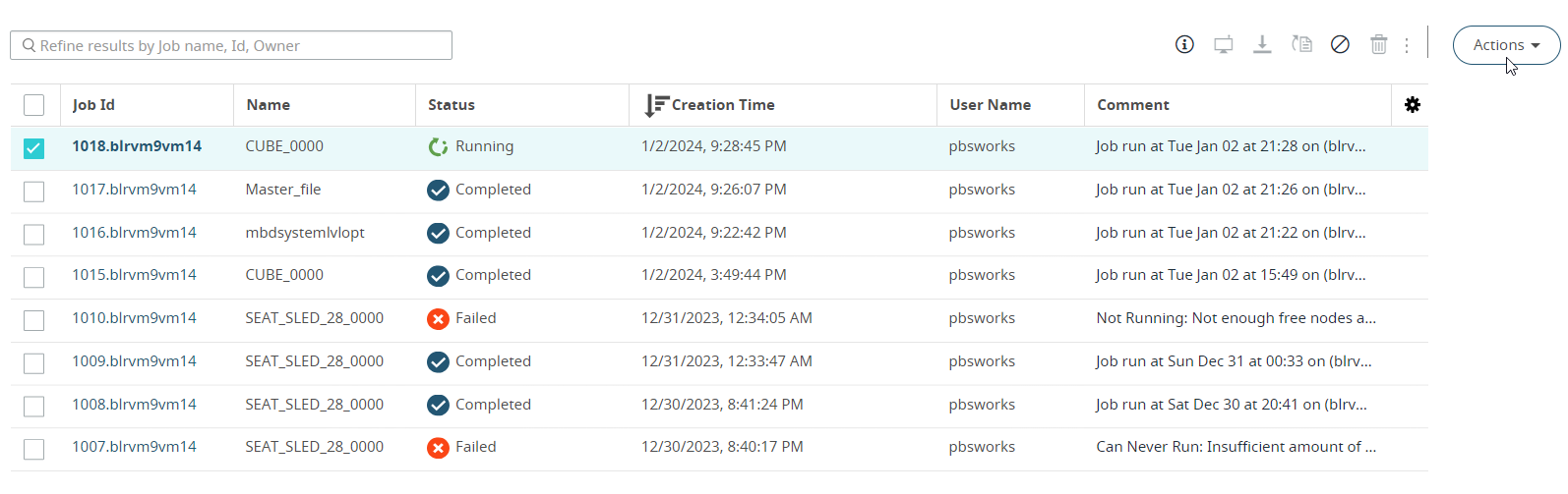

The Job Monitoring view is displayed containing a list of the jobs that have been submitted.
Select a job from the list and click Actions.
Figure 1. Job Action

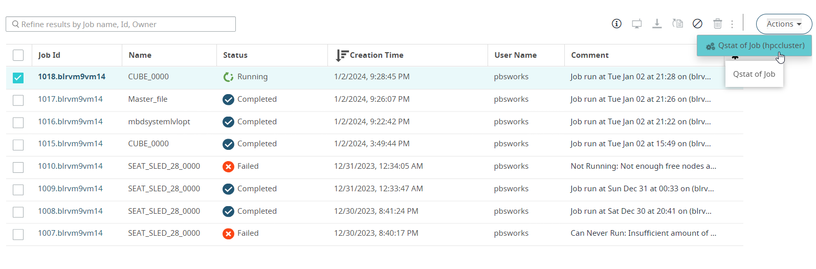

Click Qstat of job from the list.
Figure 2. Job Action List

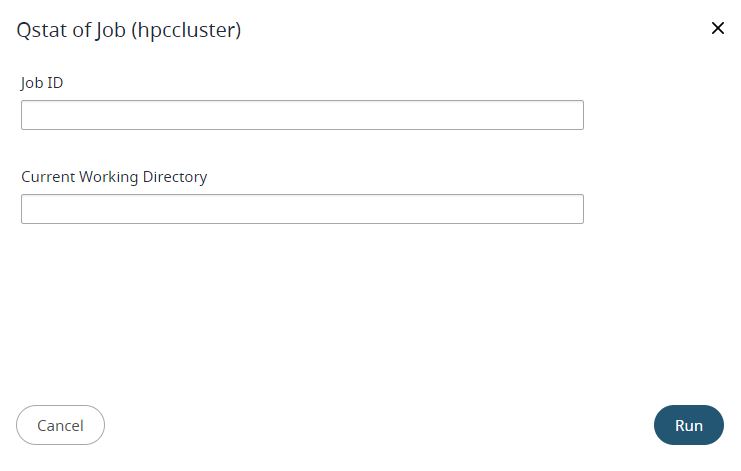

Action Menu Input Dialog Box is displayed with the output directory of the job that is selected.Note: The Action Menu Input Dialog Box will not be displayed if the generic action script does not require any input from the user. The generic action will be performed on the job and the output will be displayed.Note: If you had selected multiple jobs, then the output directory will be blank.Figure 3. Action Menu Input Dialog Box
- Enter the working directory.
Click Run

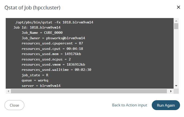

The action list performed on the Job will be displayed.
Figure 4. Job Action Display
Perform one of the following options:
- Click Close to go back to Job Monitoring list.
- Click Back to Action input to go back to Action List menu to perform an action.
- Click Run Again.
